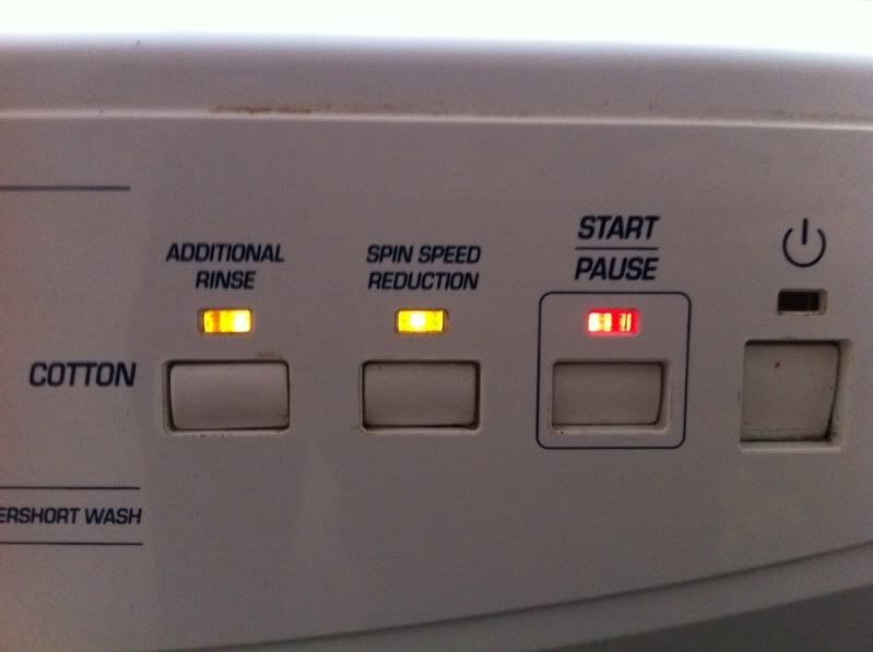

Re: Amica awct 10 L
has all the makings of a board fault
sound like the power supply to the board is not good enough
ie say power supply 12 volt (only example ) relay pulls for heater so power rail drops to 9v under this load. motor starts to turn power rail drops to 7v when triac fired. relay drops out too little voltage to hold in. power rail goes up after relay drops out so relay pulls back in again and so on
got a board in front of me. there is a blue capacitor 2.2uF that provides power through a 100 ohm resistor. To proove these may be faulty there is a green capacitor
by the plug C2 470uF 25v put a meter on this while machine is running ( you could solder wires on if you find it easier) I would assume voltage should be around 20 to 24v if you start getting voltages below 15v you have a problem most likly the big blue capacitor
hope this helps
