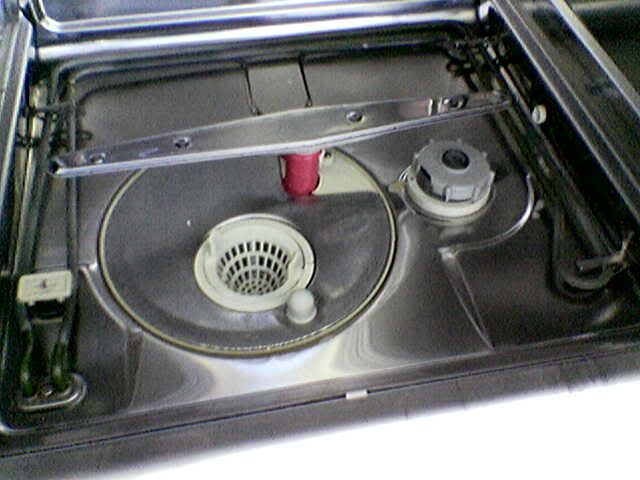

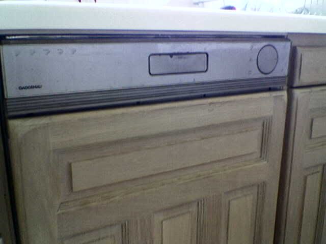

    Semi-integrated, rating label long since scrubbed clean :rolls: As far as I can tell, it’s a very old Bosch machine with a fancy control panel.
    All I need is a salt cap. Three lug job, third of a turn to close, green float and window in the top.
    Any clues welcomed!

    😕 Three lug job?
    Pic seems to show eight?
    Mike.
    #292349
    Re: Ancient Gaggenau Dishwasher……
    Internal lugs in the cap, Mike.

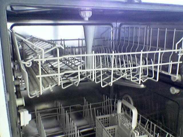

    I think it pre-dates the SMS and early 78 machines – the filters are all wrong, although the spray arm set-up seems similar.
    Seems a pity to give up on it because of a salt cap (The glasses were white with the salt leeching back into the machine).
