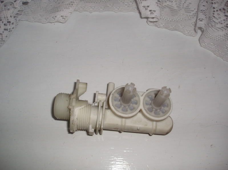

Mike.November 10, 2010 at 8:18 am #335293Phidom
ParticipantRe: Arsiton water valve screw on adapter A1535
I found the remains of the one I tried to butcher to remove the extension bit:
