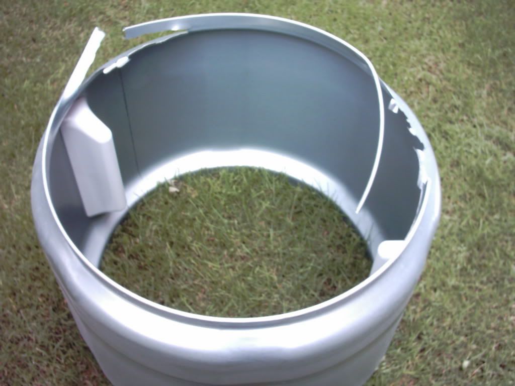

Last one I had clonking……….
Useful though – it’s now the inner wheelarches on the Wolseley!

Oh dear 🙁 . Hope I don’t have to make some new mudguards for my bike. Good idea for re-use though.
