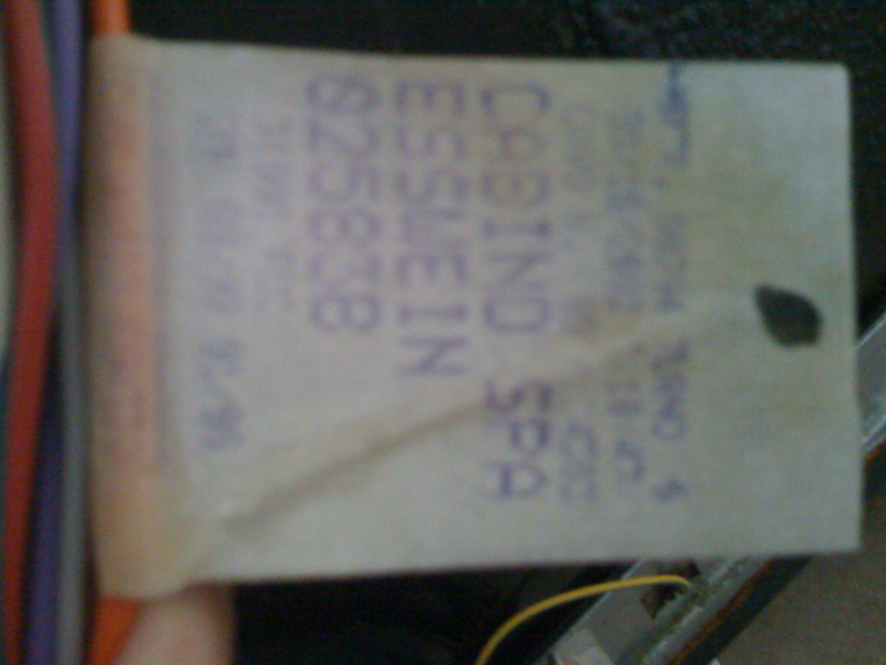

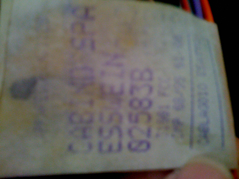

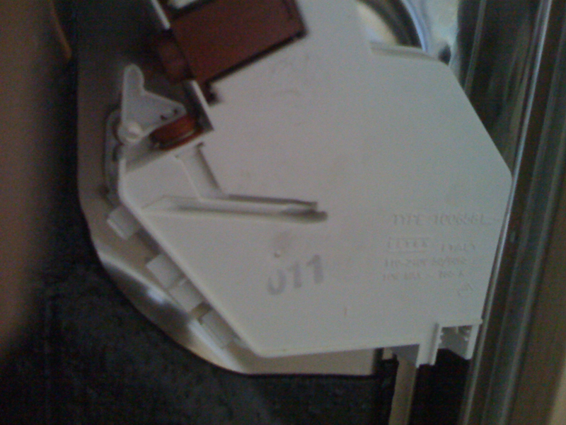

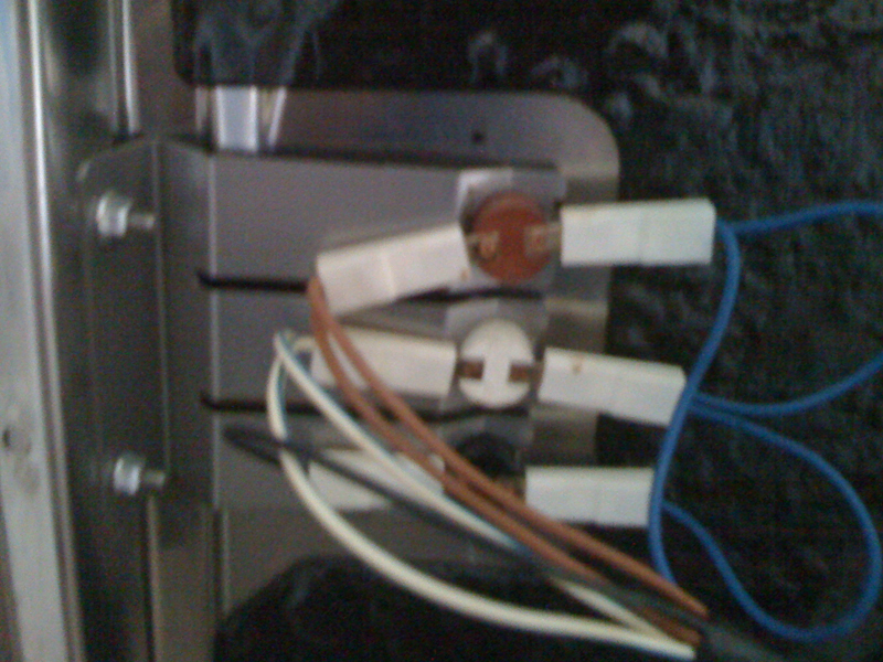

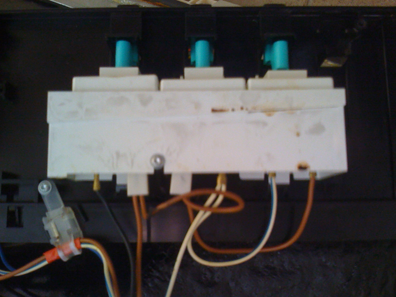

    I have just taken some pics to help with the ID as you know, Bernstein went pop a while back. Mine says made in France on the worn sticker, and alot of the internals are in Italian.
    Hope this helps:::
    #296873
    Re: Bernstien Dishwasher playing up AGAIN
    Doesn’t help much as, in order to look up parts or any information everything and, I do mean everything, is geared to work from brand, model number, serial number*, rough diagram, part number.
    *At this point you can get technical, if there is any.
    I know that’s a variant of the old Brandt things but which one, who knows. Nothing comes up under that model number but, since Bernstein have been bust twice since these were around don’t be surprised if most stuff for it is NLA.
    Also, Brandt has been passed about two or three times since then. Plus, Brandt’s attitude is that, if it’s over about eight years old, parts go NLA.
    MFI also used these for Hygena and Diplomat but parts are getting scarce.
    What I’m saying is that it’s getting on a bit and probably due to retire to a recycling centre. 😉
    But check the wash element which should look like this if memory serves, either that or it’s the other one we used to use a lot. Common failure on those.

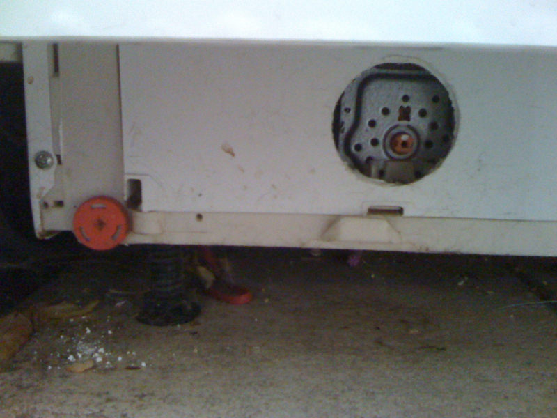

    Remove lower cover panel (the one with the hole cut out of it). Heater should be to the right. No need to remove – disconnect power and the leads to the heater to avoid back readings and test across the terminals.
    If there is a safety thermostat, it’s round the back of the sump moulding.
