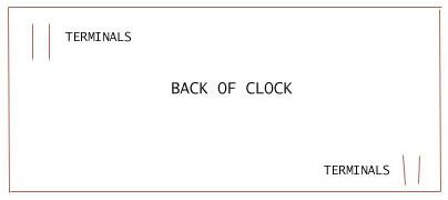

    rocker
    Can anyone please tell me the connections to the clock as I made a diagram(below) which are the 240 volt input terminals & the switch terminals.
    Thanks for all your help,
    John. 😀

    #223919
    eastlmark
    Moderator
    Re: Bosch Oven HBN222BGB/02 (updated)
    Should be easy to check, just see which pair lead to a relay.
    #223920
    rocker
    eastlmark wrote:Should be easy to check, just see which pair lead to a relay.
    Thanks alot for your help, but would you please be able to give me some more information about what relay you mean?
    Thanks.
    #223921
    aqualectric
    The relay will be a small rectangular box (usually white) with 2 terminals on one end. Those terminals are the switch for the oven on /off supply dictated by the clock setting. 😉
    The other set of terminals will usually just go straight on to the PCB. These will power the clock itself.
    HTH,
    Steve
