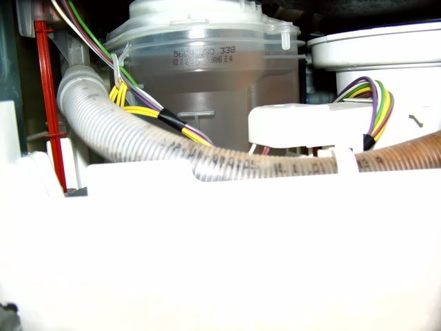

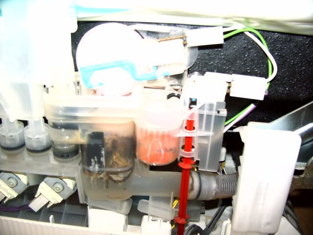

    The standard fault on all modern Bosch dishwashers is sludging in the the lower transfer pipe and pressure chamber, which causes under-filling. As a consequence, insufficient water is circulated to operate the diaphragm switch on the end of the heater box.
    It is possible that the heater has failed, but normally a strip down and clean will do the job.
    This hose is a primary culprit.
    If cleaning that out doesn’t do the job, this is your next step.
    Heater itself should read 25-30 ohms when tested with a test meter.
