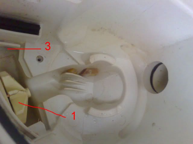

June 22, 2008 at 3:13 pm #255583mikeattewell
ParticipantRe: Bosch SGS5312GB/12 not emptying
Hi Greg
This post was started my dad who’s trying to help me get my dishwasher sorted
I connected the compressor onto location 3 in the picture, when air is blown it is free to flow through to location 2
Part 1 does twang when I turn it by hand

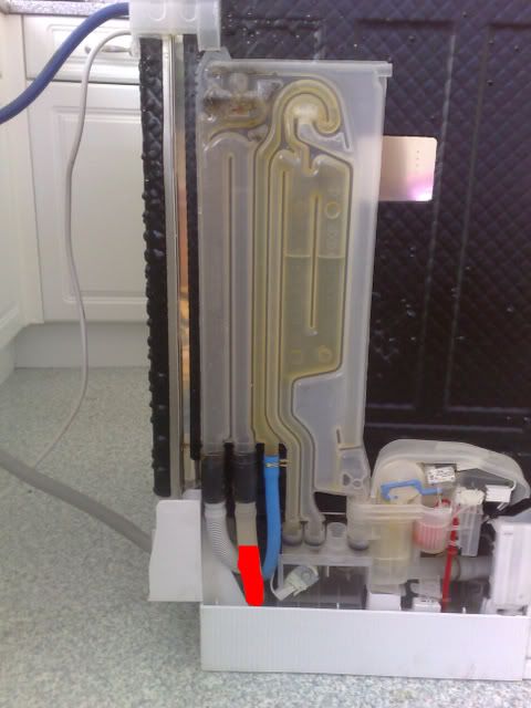

June 22, 2008 at 4:20 pm #255587mikeattewell
Not a drop 🙁
Once filled I can see the water level through the pipe as i’ve marked on the picture so I definatly think a blockage isn’t the prob
