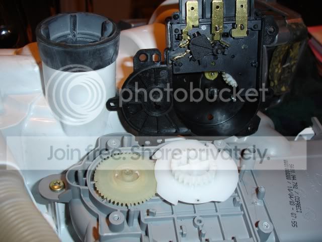

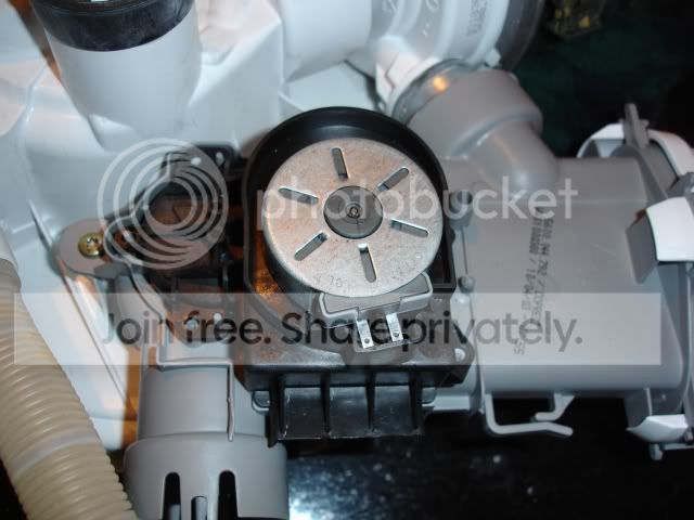

    This is the part thats causing all the grief;
    And this is it with the motor opened;
    There is no sign of water ingress, so not obvious why the diverter was not moving.

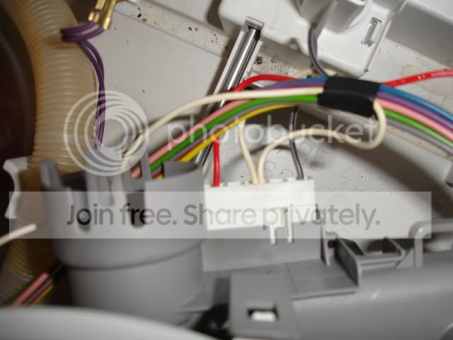

    I want to check the motor, I see that its 230v, can anyone tell me the purpose of the three connectors – I expected two?
    The two connectors shown in the top photo are not connected – the three in the bottom photo are connected to a red, double white, and grey/black;
    Thanks
    Regg1e

    When power is applied, the motor turns the diverter without any problem, so can’t see that this is the root cause of the trouble. There is no sign of water damage / corrosion.

    I’m dealing with the same issue here with a slightly newer (2006ish) dishwasher. Faced with a £120+ part with no guarantee of fix situation, I’m looking how to extend this appliance’s life if possible into the new year. I’ve got the divertor valve apart and except for a bit of slop between the final drive gear and the round valve plate everything else seems to be ok. I was planning on gluing the gear to the plate to take up some of the slop but have lost track of which position internally aligns with the wide tooth on the gear wheel.
    Bit of a stretch, but does anyone have that detail?
