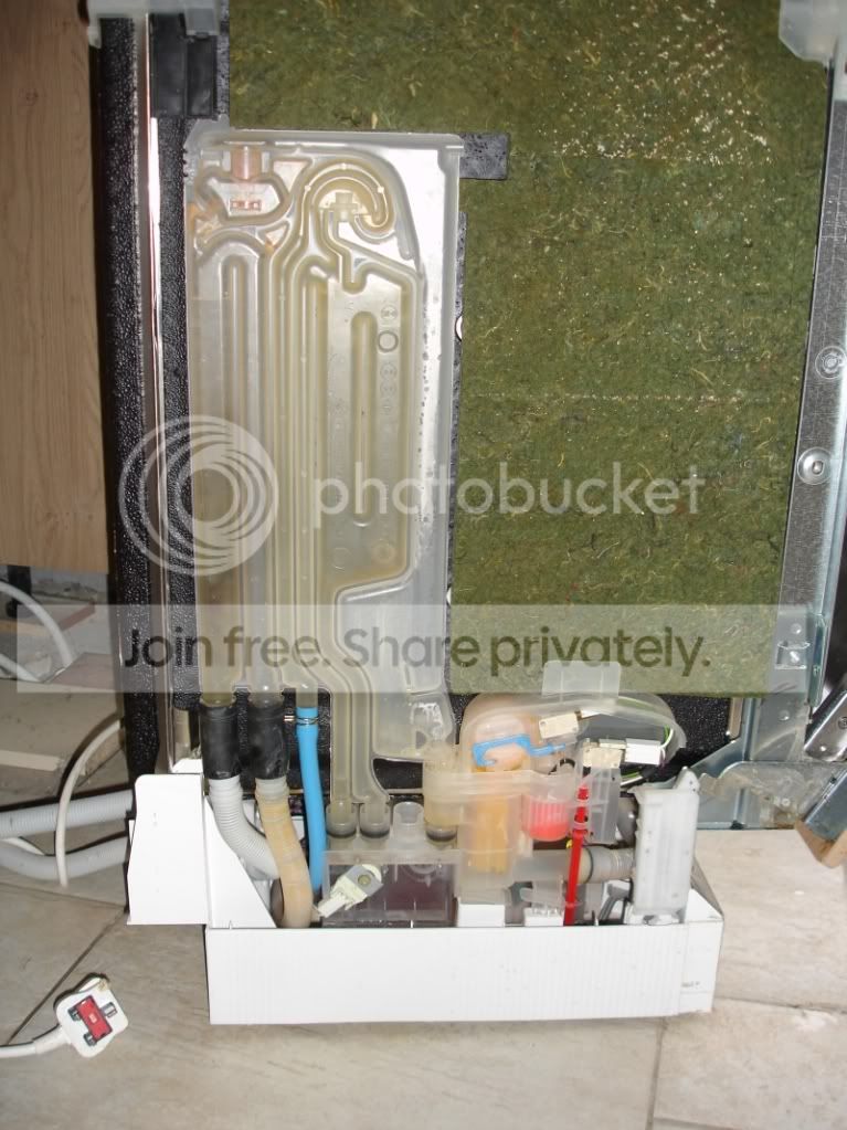

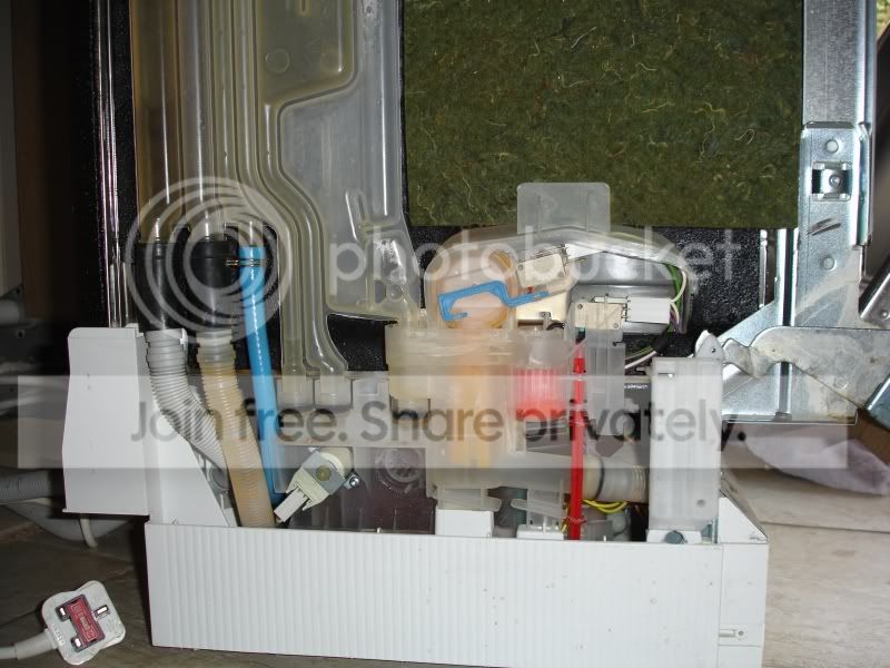

Though just now when I tried it, the top sprayer moved, but not the bottom one 😕Hopefully, if I’ve got the links right, these are pictures of the Matrix (and the Oracle 😉 )
(notice the plug in the picture – just for you Goatboy! )
Goatboy: Which pipe is the main feed to the DW from the Matrix – is it the second from the left in pictures?

March 15, 2009 at 5:37 pm #280318spimps
ParticipantRe: Bosch SHV43a – repair or replace?
Th corrugated pipe that runs horizontally from just behind the red operating rod for the overfill goes to the central plastic part of the sump.It’s a push in fit at both ends,take out and clean,if it’s blocked the machine isn’t taking in enough water and the top spray arm is starved.
Clean and try again.

spimps: unfortunately this pipe is absolutely clear – no blockages at all. And there is no shortage of water in the tub either – very good spray from the one arm thats working!
