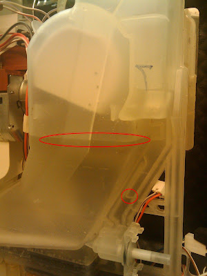

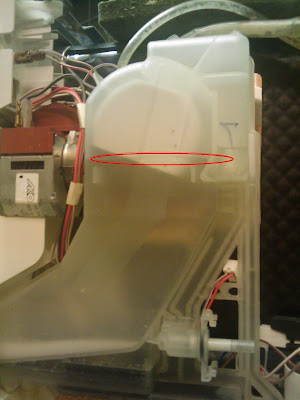

March 24, 2009 at 10:55 pm #280847kmj_raunds
ParticipantRe: Bosch table top dishwasher problem
I have taken the dishwasher apart and I have taken the valve out and cleaned it. It looks to me as if the chamber is over filling and slowly draining, even though I have removed the solenoid. I have attached 2 pictures to show the water levels the 2nd picture has 2 red lines one for the main chamber and 1 for what i think is the filling tube it looks like it is draining slowly. The softener level is set to the lowest value. The water level gets so high it looks like it also leaking from the salt scoop.
I think it is over filling in the 1st place. I could be wrong. Has anyone got any ideas?Karl

March 25, 2009 at 12:27 am #280848Penguin45
The chamber should only drain down when the solenoid valve (bottom right in picture) is activated. If it is slowly draining down, the valve is leaking and should be replaced. P/no 065539 – spares@ukwhitegoods.co.uk will be able to supply one for you promptly.
March 25, 2009 at 7:46 am #280849kmj_raunds
Hi, I don’t think it is the valve. because of the following.
The Chamber fills to a very high level thought the inlet pipe. the Chamber the empties quickly down to the inlet pipe level, with water going back out of the inlet pipe. The chamber the empties slowly until the water level reaches the bottom of the entrance where the salt is inserted. After it gets to this level I see the Inlet pipe slowly empting of all water until the intlet pipe is empty. The Water in the chamber stays constant if I stop the dishwasher. The rest of the chamber does not empty.
At this point the Water level does not change until more water is added to the dishwasher and the process of up and down starts again. 1 enitre scoop of salt was consumed in 1 wash cycle.
Karl
