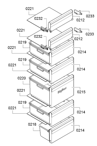

    Hi I have a Bosch Upright Freezer E-Nr number GSN33VW30G/03 , I managed to break the original drawer flap so ordered another direct from Bosch (part number 0078732) shown as item 0212 in the diagram below.
    I’m struggling to fit the new flap onto it’s mountings which are items 0232 & 0233 shown in the diagram.The mountings each have a horizontal pin which fits inside a hollow section at the bottom corners of the flap. The problem is that the drawer flap is too wide to fit onto the mounting pins on items 0232 & 0233.

    Can anybody give me any help re fitting a new upper drawer flap to this bosch upright freezer or advise where I might find some instructions?
