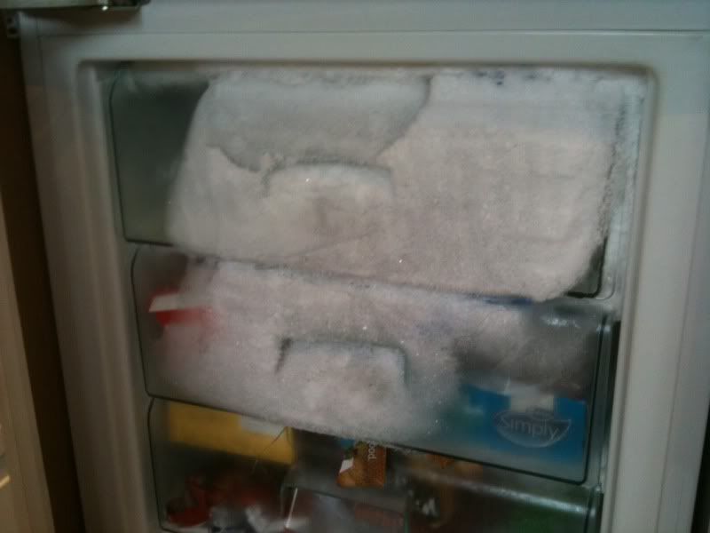

    I have a Brandt integrated freezer which over the last year has had a lot of frost build up – I suspect because the seal isn’t good. It looks like it may be the door not closing properly?
    Here’s a photo of the ice build up.
    It’s constantly doing this. We will defrost it and within a few days it’s like this again. I’m hoping it’s an issue with the door hinges maybe? Or the actual seal around the edge.
    Any thoughts?

    If it is integrated , I would check and make sure the panel door isn’t stopping the freezer door from closing – maybe undo the fixings so the freezer door can move independantly to the panel – it certainly looks like it is a sealing issue there

    Update: I replaced the bottom door hinge (£32!) and after a few days it’s still completely frost free!!
