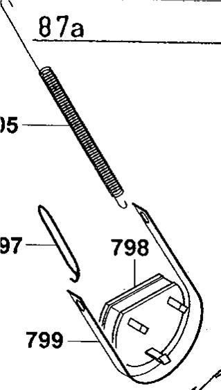

    Door spring has gone and I’m not sure how to replace it! I’ve taken side off (left panel) as looking at it and found the broken bits! Is there a diagram anywhere to show how to replace spring? The machine has also recently stopped drying the contents – especially cutlery – as it use too? The machine does seem to be hot at the end of the washing cycle – steam if open the door. Any thoughts? Thanks
    There is also a thin/flat metal strip/spring which seems to wrap around a semi circle shaped plastic object on left hand side. how does this fit into the process? On the right hand side there seems to be a simple connection between the door hinge and bracket near base of machine – this spring seems to be ok

    Thanks Penguin 45, so it doesn’t attach to the door hinge. I wondered what the other paper clip type hook was for! I’ve ordered up a replacement spring. Any thoughts on the drying problem?

    Part arrived yesterday and of course it does connect to the door leaver/hinge! Works a treat which her who should be obeyed really appreciates. Thanks for the diagram Penguin45, just need to sort out the drying problem! 🙂
