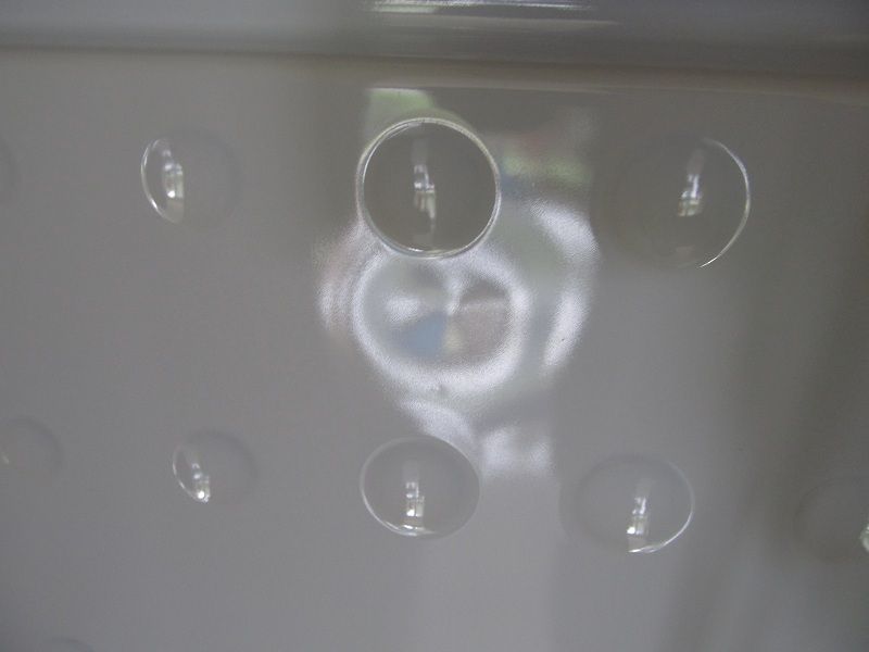

ParticipantOur new freezer has about 3 golf ball sized dents on the inside of the door. Not very noticeable and obviously only when the door is open. Before I plug it in I just wanted to know if the dents could in anyway affect the performance of the freezer. They’re not near the seals and the door closes fine. Want to know before deciding to keep or ask for a replacement.

Here are some pics of the dents.

These photos are not actually dents.They are of the expanding foam which you cannot guarantee a full even expansion.There is no actual fault with either the door or liner.

Are you saying expanding foam was used inside the door? Out of interest, do you know what the circular crators are for?

Yes to the foam and the craters are there to add strength and rigidity to its form. 😀
