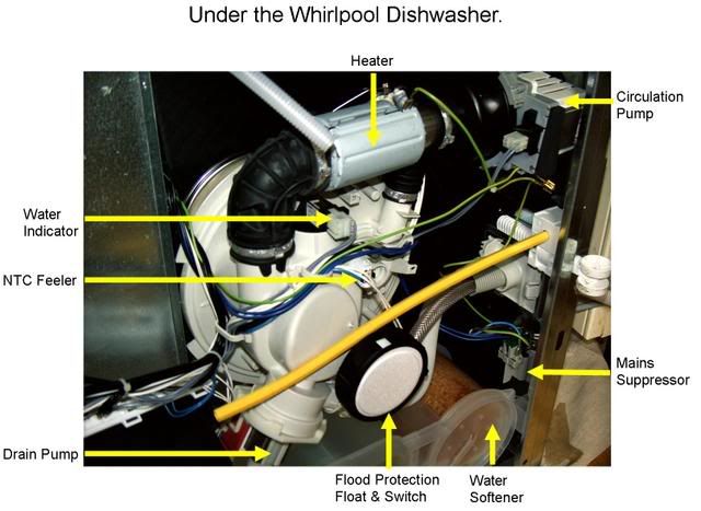

    The beeps can match the flashing start lamp – 3 suggests a heater circuit failure. Buirnt-out wiring at heater connector common, dead heater or safety stat and possible failure on PCB. Had one recently with wiring failure in door pivot point.
    It’s a Whirlpool – all code info is available in Known Error Codes Thread and teh UKW Fault Code Guide book.
