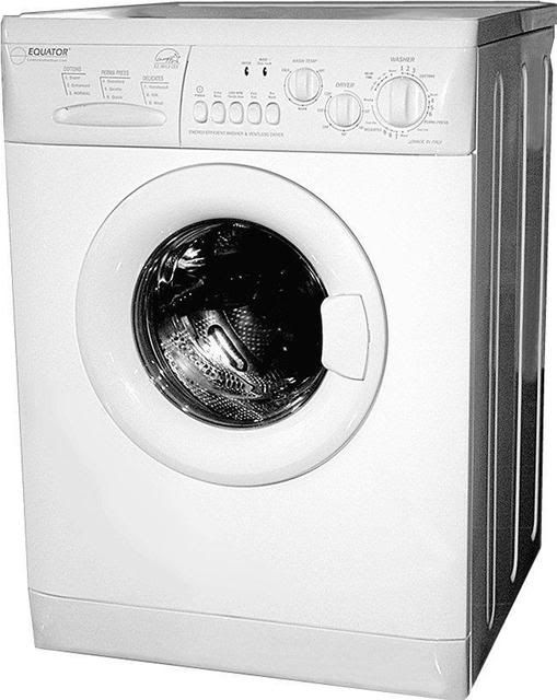

ParticipantHi all,
I have an Equator Washer Drier EZ3612CEE (unfortunately). I own this machine for 4 years and it has been repaired 4 or 5 times already. So I am ready to give up but I decide to give it a last shot . I know that whatever I saved with machine energy high efficiency, cost me 10-20 times more in repair cost. But anyway – the machine start again to malfunctioning. In the beginning some water gets in, but the motor does not rotate. Water comes in small portion 2-3 times. After about 1 minute wash timer start to rotate endless (clicking) and water pump start pumping the water out. The light is blinking wired also. After the water is pumped out, the dryer vent motor rotates for another minute and then the machine stops. Please, help me with any possible information.
I assume that the control module is gone, but it was replaced once already 2 years ago. If it is – can I find anywhere an electrical diagram of this control module. And how can I check if is bad before I try to order it. It is quite expensive (if I can find it, of course) to order it without knowing that this is the problem. Do you think it can be something else. There are not to many parts in a washer/dryer combo.

And the machine does have hot and cold water fill. And hot water fills in. But in front of the machine there is a knob for wash temperature control. I was thinking that this can control the washing temperature. But obviously, if there isn’t a water heater the machine will work only with water from the supply pipe (whatever temperature is there). I think that means I can control only how lower then supply pipe water temperature can be. But not that I can increase the water temperature above hot water from supply line.
Well, I guess I should live with it.February 26, 2009 at 1:44 am #276380Penguin45
ParticipantRe: EQUATOR EZ3612CEE malfunctioning – wash timer is rotatin
It’ll be a max temperature set-up in that case. It will run the hot valve, then add cold to achieve the wash temperature. Bit basic, but it does mean that you won’t get the infamous F8 code!
