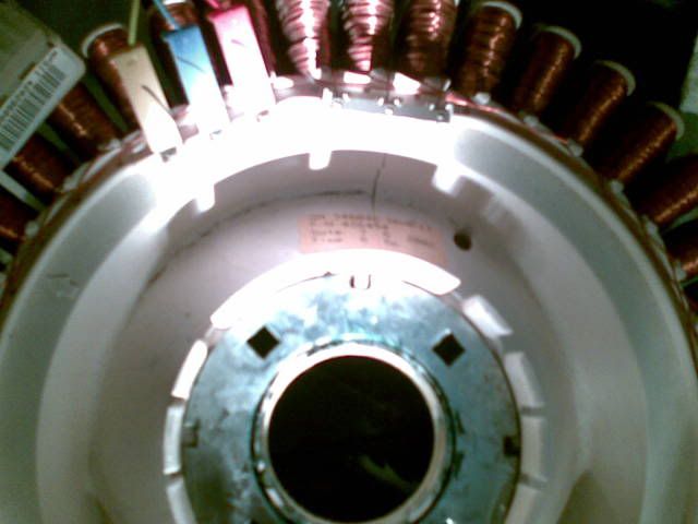

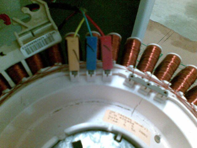

    well I pulled of the rotor ferrite and low and behold there was issue #1, a nice big crack traversing from the bridged terminals to about 13mm short of the centre:
    I then had the bright spark idea of doing a continuity test on the RPS itself, there was very intermittent continuity while testing all the terminals – importantly the values changed on my DMM but no buzzer and after about 1 sec the value would return to 1…
    So I have the new stator now (old part# 426454 and new part #426454P) but also found that the RPS wont fit to the new stator…
    Apparently Fisher and Paykel doesn’t make the original stator any more, would that be right?
