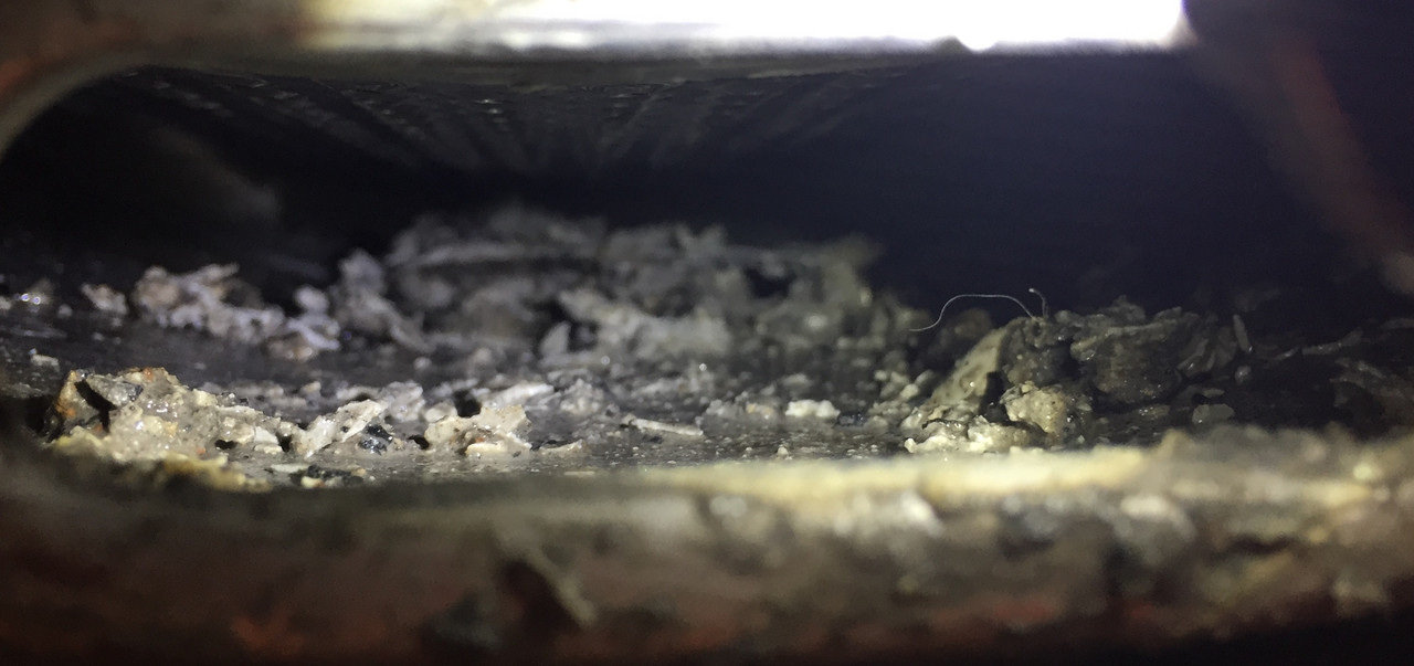

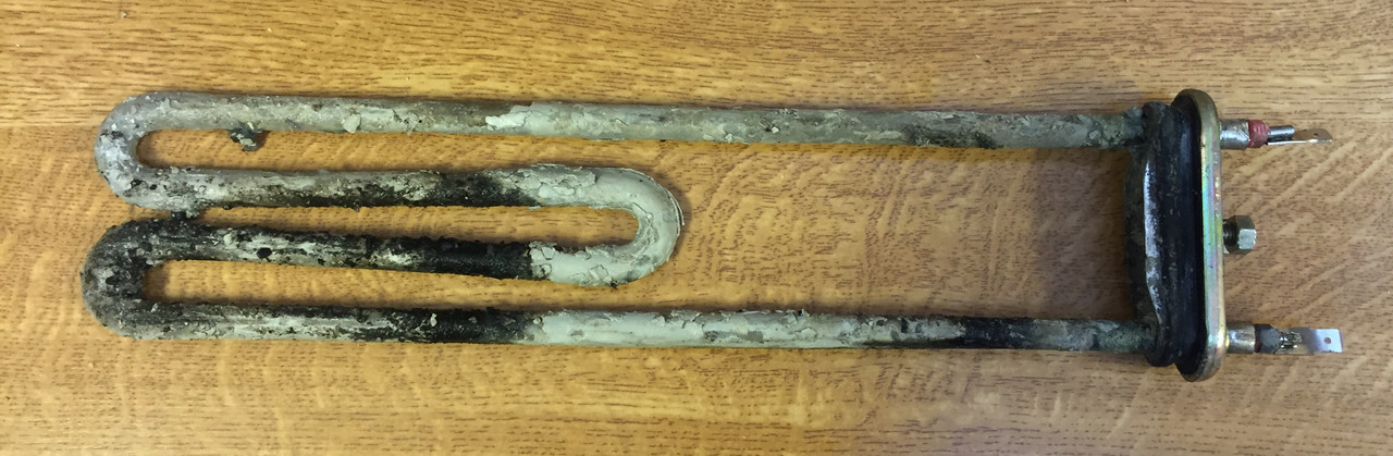

October 2, 2018 at 8:06 am #458217aris
ParticipantOk, I drained it all just in case, and pulled the old element out. What a mission. There was so much crud in there, I struggled to pull it out. Even when out half way, I had to use a fair bit of force to get it out – but it is out and is not pretty. Additionally, there is a load of crud there at the bottom of the tank with a fairly small access hole. Do you guys have some tricks of the trade to clean it out? I’m thinking I may have to make a tool of some sort out to scrape it all out.
I’ve attached some piccies.
[IMG2=JSON]{“data-align”:”none”,”data-size”:”full”,”src”:”https://i.postimg.cc/W1ZwcvXf/IMG_2658.jpg”}[/IMG2]
[IMG2=JSON]{“data-align”:”none”,”data-size”:”full”,”height”:”419″,”width”:”1280″,”src”:”https://i.postimg.cc/Hk8BW5sz/IMG_2656.jpg”}[/IMG2]October 2, 2018 at 8:55 am #458218electrofix
Moderatorno easy answer to clean it out. bit of old wire coat hanger with a hook on the end can help getting at the awkward lumps
October 2, 2018 at 10:31 am #458219aris
ParticipantWell it is installed Cleaned out as best I could with a thin rod – some crud was left in there though. After installing the heater and re-installing the sensor, every thing is working fine. I just did a few 90 degree rinse cycles to flush out the crud.
The element itself was spot on – practically identical to the original, and quick delivery from UKWhitegoods. Thumbs up from me!
