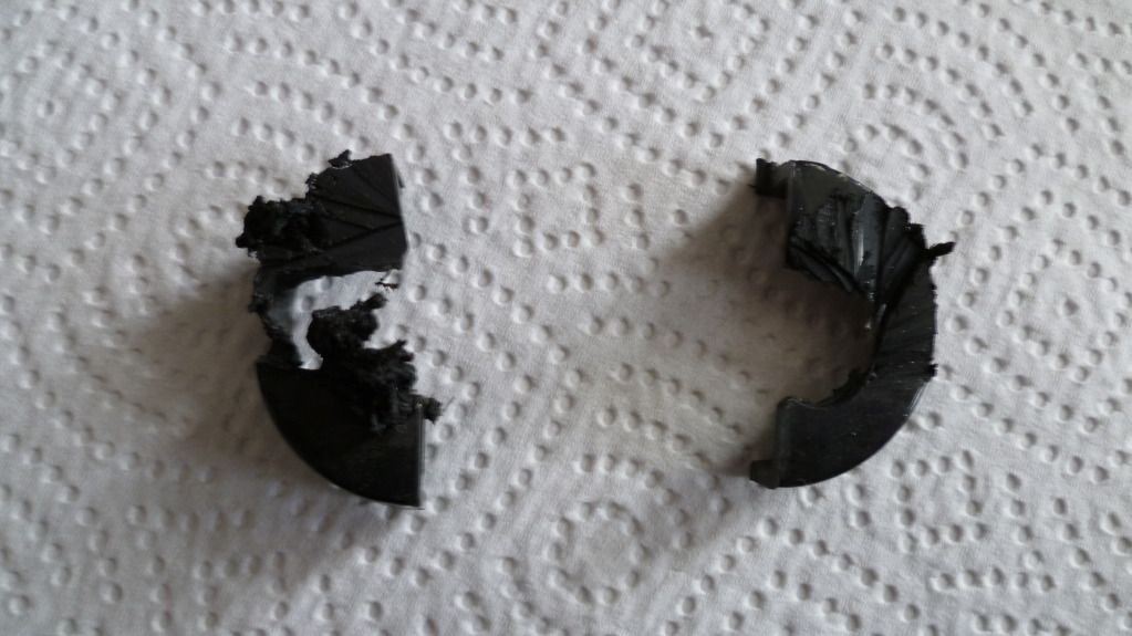

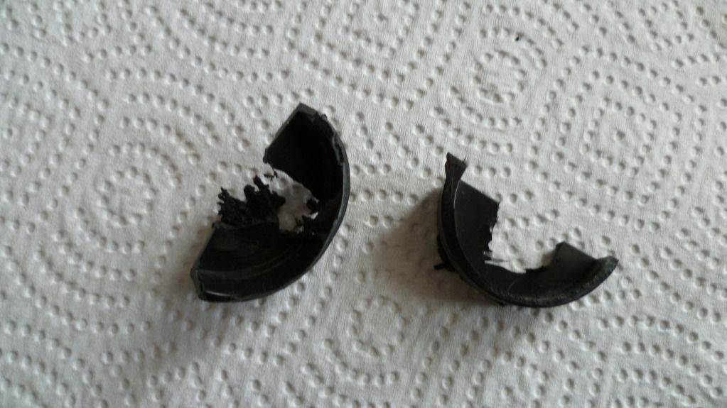

    Hi there, my trusty Hoover Purepower has malfunctioned and when I opened it up it looks like a round spindle has broken in half.
    It looks black, about 1cm thick and 3-4cm across. I’m sure it holds the belt in place beacause the brush had stopped spinning and when I opened the hoover up the black thing fell out in two pieces.
    I tried to put the belt back onto the metal bit that spins but it just keeps slipping off.
    Can you help me name this piece please so I can but a replacement?
    Thanks very much for any advice

    Hi guys, thank you very much for your replies and sorry it took me so long to get back to you.
    I have taken two pictures of the piece.
    The model number is U3495.
    Thanks again for your kind assisstance.

    Thanks for the photos, as I thought those bits form part of the top motor housing cover..
    The cover is available for around £10+ vat
    And also available is the bag housing, which also gives you the bottom half of these half broken pieces.. All depends on if these pieces are off either side of the top cover, or one piece is from the top cover, and other one is from the bag housing
    Bag housing, and motor cover together are around the £25 mark
    Hope this helps
