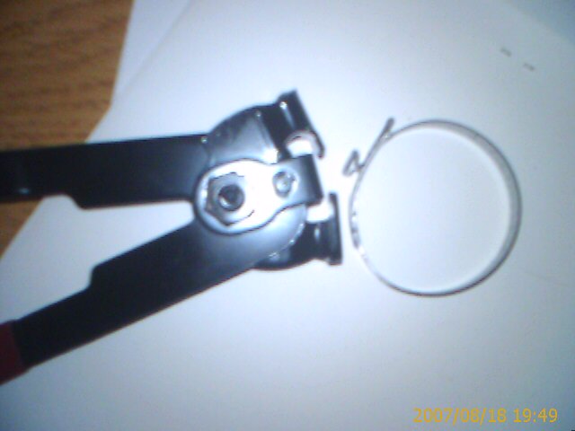

ParticipantFound these hose clip pliers in a motor-trade tool shop the other day.
http://www.ccw-tools.com/product.asp?P_ID=3690
They are perfect for fitting the metal clamps found on many dishwasher internal hoses.
Bob

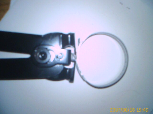

August 18, 2007 at 7:05 pm #225026bobokines
ParticipantRe: Hose clip pliers
These are not for the spring clips. They are for crimping the metal band types.
Only used them yesterday for the first time. I used it on the supplied hose clip that comes with the merloni dishwasher pump. I’m sure it will work on any crimped type clip that we see in this industry.
Bob
