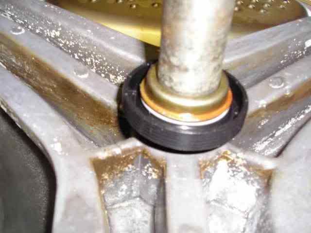

ParticipantHotpoint WMA52 bearing job. I quoted assuming it would be the normal large shaft bearings but when I got the old ones out I found it is the 30mm shaft type. I was looking at the seal and trying to figure out how it works. It is in 2 parts, a conventional garter seal and a central part which is a plastic cone at one end and a steel bowler hat shape at the other. It came assembled with the plastic cone inserted in the garter seal but I’m not sure if that’s correct. When fitted on the shaft the centre section is a tight fit so it is evidently meant to turn with the shaft. This means it is turning relative to the garter seal so the moving parts will need lubrication. There is hardly any grease on the garter seal but there is plenty of grease on the sides and brim of the bowler hat part of the centre section. Does this mean the garter seal is supposed to run on the bowler hat bit? Photo shows it how the seal was assembled as received:

Im sure it goes in as it is in pic .
March 26, 2008 at 8:36 pm #246996Phidom
ParticipantRe: Hotpoint 30mm Seal (Again!)
That’s good because that’s the way I did it. I’ve just come back from the workshop 🙂

In theory this new type of seal should mean less scrapped spiders as both the fixed and the rotating surfaces which form the seal are renewed just by changing the seal.
