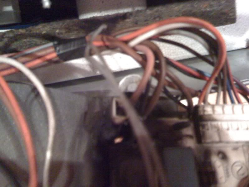

    #327361
    baileyyogi1
    Re: Hotpoint Aquarius FDW60 – Fault.. please help 🙁
    Hi iadom, couldnt log on in my usual id so re-registered!
    Here are the photos of the control/circuit panel
    Hope they are good enough quality
    Thanks again 🙂

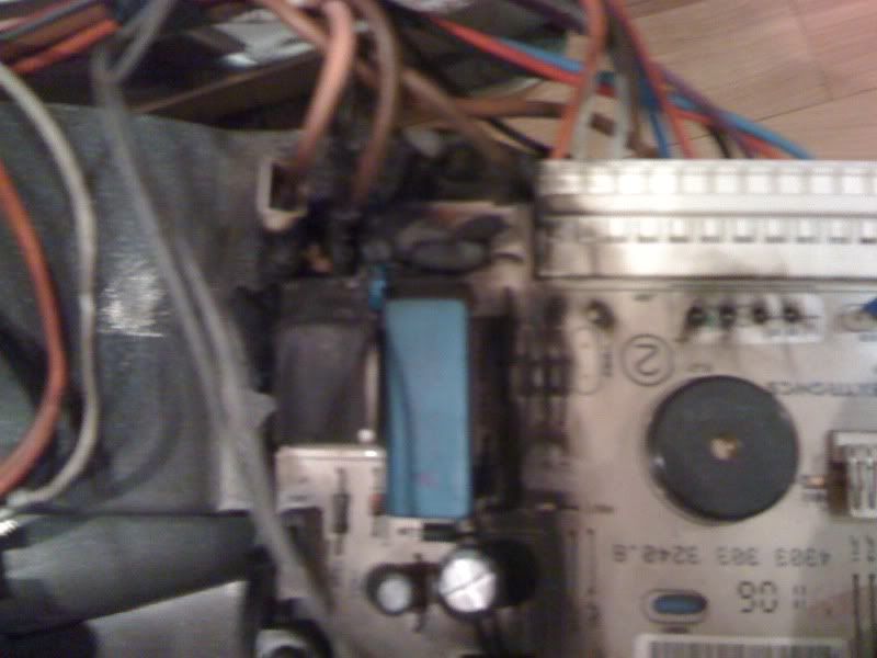

    #327362
    baileyyogi1
    Photo 2

    #327364
    TBH that looks like a localised problem, that sort of damage is rarely caused by other components if ever. Is it possible that it could have suffered water ingress from the worktop above at any time?
    Might have made a bit of a mess of the wiring harness though. 😥
    There at least two different PCB’s for this machine and they are both around £60.00 ex vat.
