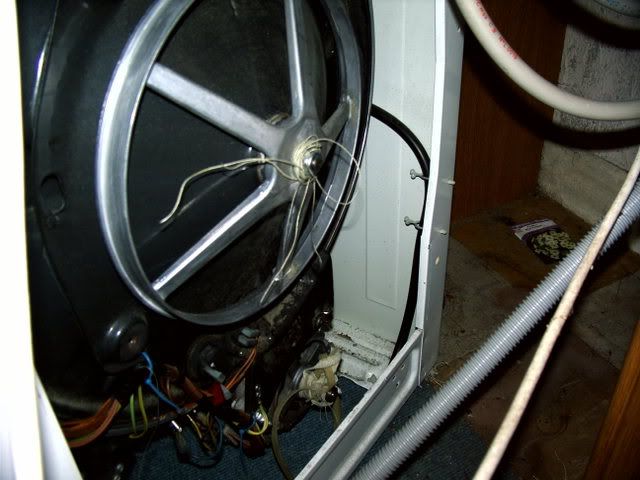

June 28, 2008 at 4:16 pm #256042Penguin45
ParticipantRe: Hotpoint WM68P – drum doesnt spin
Get a lot like this these days:
Note motor shaft at the bottom. This one miraculously missed the wiring.
