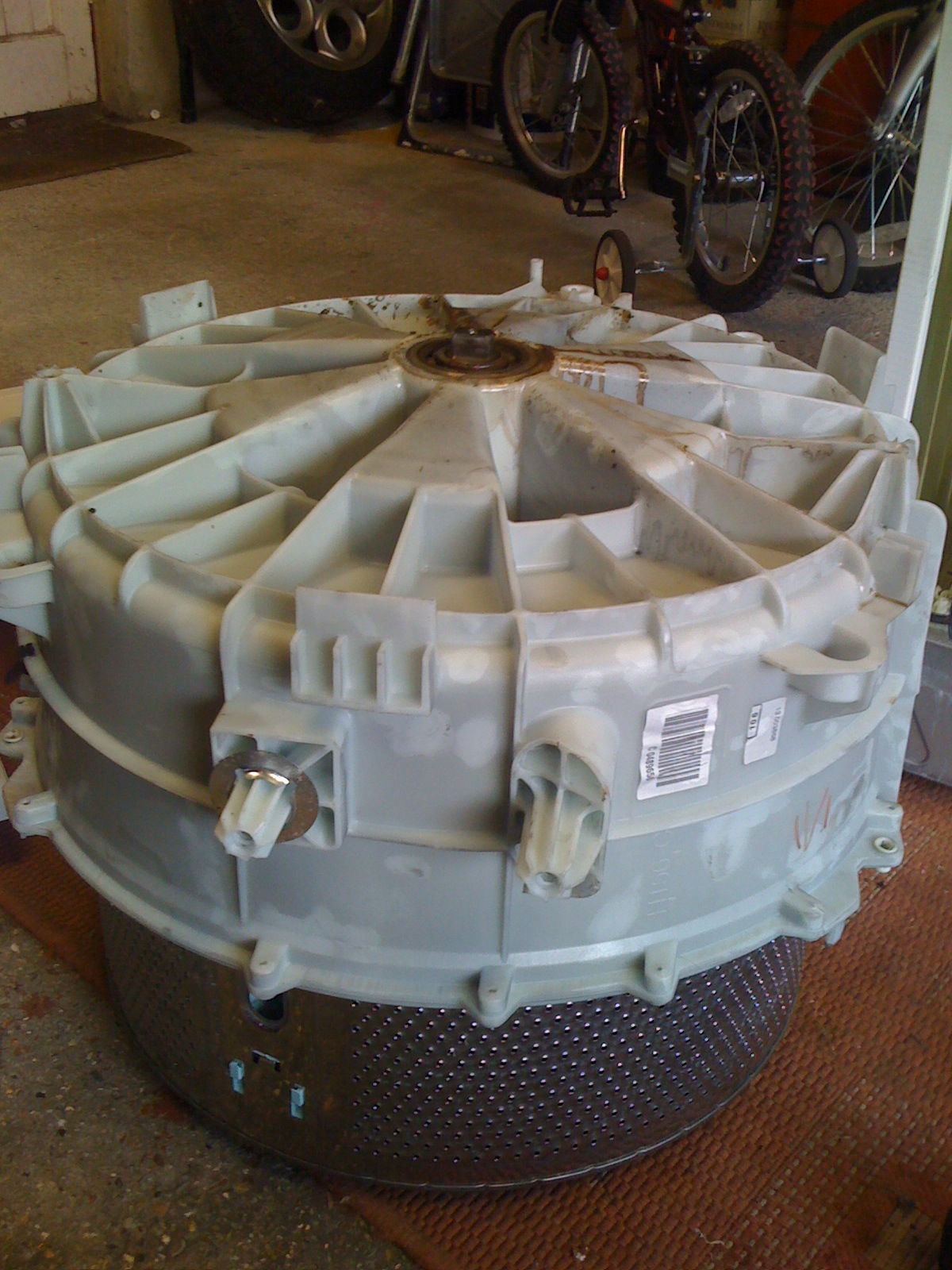

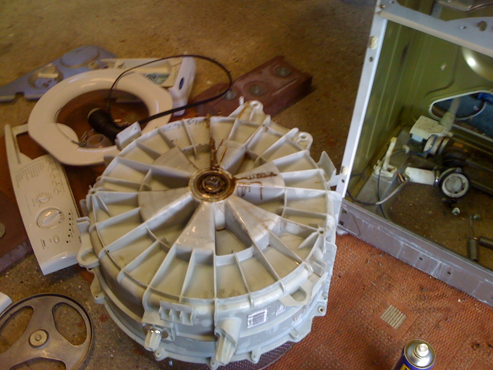

    Ok, the drum is out, not bad, about an hour, but I took my time.

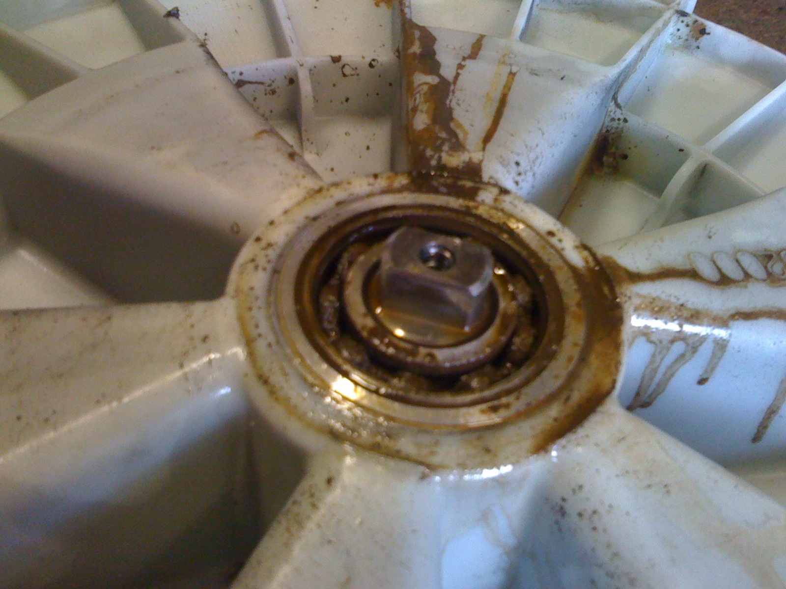

    Now I am here, and a bit lost as how to get the bearing out, it is utterly shagged, loads of play, front case fell off, but it appears well stuck. I have a rubber mallet, plus bigger lump hammers. I have gone at it reasonably hard with the rubber, but have not used anything more on it, as I dont want to shag it up.
    Anyone give me any pointer on the best way to get it out?

    helo_75
    the inner drum needs to come out.
    to avoid damaging the thread of the drum, use a suitable bolt, similar to the pulley bolt, and tighten it up until the threads are taken up.
    then bash it out with a big hammer
    the bearings, and yes theyre bad, will come out then, you can bash the rear one out from the inside using a suitable drift, the inner bearing wll then knock out from the back
    try and use something to draw the bearings in , or theyll end up noisey.. and make sure the shaft of the drum is in good order, or it may need replacing

    Sweet, worked a treat, the drums are now separated. Just got to work out how to get the 2 old bearings out of the nylon tub.
