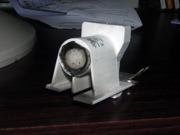

    Im trying to source a part for my neighbours dishwasher which recently went pop.
    The dishwasher manual says the model number is: DV 620K IX UK
    S/N: 312043593

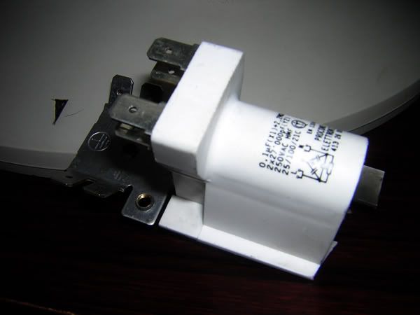

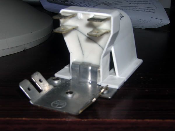

    I believe from a friend that the part is a line suppressor made by “Procond Elettronica” (see images)
    The text on the part itself reads:
    0.1μF ( X1 )+2.2 MΩ
    2×27’000pF( Y2 )
    250VAC HMF
    25/100/21C
    There is also a circuit diagram which may be difficult to read from my images but if needed i will reproduce this diagram on request.
    If anybody can help me to find out a parts code for this item aswell as a place to order a replacement for it i would be extremely grateful. Or would the machine run without this part? My friend seemed to think it would run ok if i connected the live to live and neutral to neutral without this part but might interfere with tv/radio.
    I thought i would seek more expert advise before thinking about trying this.

    Mains filter, a legal requirement I’m afraid, the neighbours may not like it if it interferes with their reception but to be honest there isn’t a lot of interference from a dishwasher.
    Unfortunately I cannot see that part on the official parts diagrams or in the parts list. 😥
    It shows the mains cable and you would expect the filter to be next to it but there is nothing.
    That said, a lot of more recent washing machines have a mains cable and filter combined but this is not listed as such.
    Hopefully one of the helpful people who are privy to more restricted information 😉 may come to your assistance. In the meantime I will keep looking.

    Part number C00076659 (pos 19 on the diagram Jim, I had to do a part description search to find it though 😕 )
    Cheap enough at £8.77 inc, an email to spares@ukwhitegoods.co.uk please if you’d like one ordered 🙂
