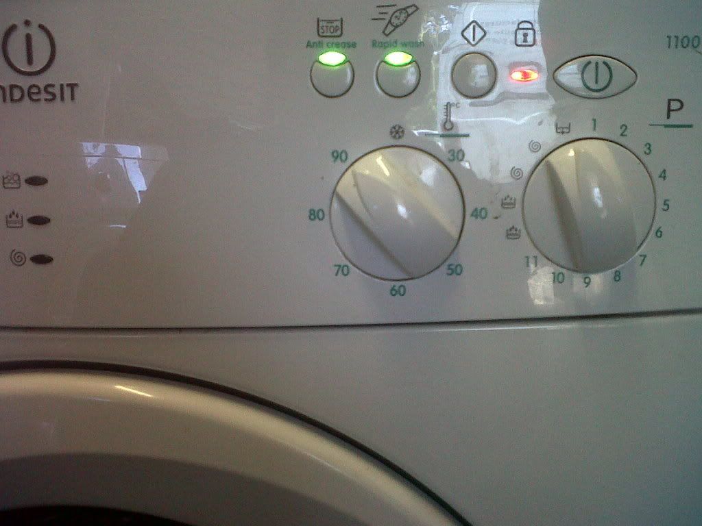

    #298994
    jackster
    Re: Indesit WIB111/UK
    Hi all,
    Sorry to bang on about this one but, I have replaced NTC but still the same. I have checked out all the normal culprits, element, valves etc and still no joy. I have postd below a pic of the fault code display, I calnt find it anywere. I have got a feeling it must be PCB?
    The 2 x green are flashing continuous, no pauses

    #298995
    Davecas
    just had similar one & found dry solder joint on board for heater relay, worth checking?
    dave
    #298996
    jackster
    Yes I had one doing that myself a few weeks back and cured in exactly the same way, unfortunately this one isnt playing ball!
    I can only think it must be module, i have tried everything else! New NTC, heaters ok, wiring got no breaks etc…
