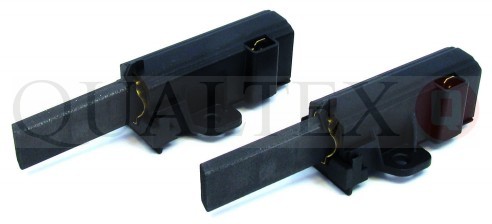

    These are the old brushes & holders, they look very much like ones that I have seen on Zanussi/Lux machines in the past, darned if I have a part number though.
    Its possible the thread I was looking for was referring to a CESET motor, it appears that the Indecent Company don’t want to supply brushes for any recent motors. :rolls:
    #360436
    Re: Late Hotpoint motor brushes.
    Looks very much as though the Qualtex CAR99’s will fit. I think you’ve got a copy of their c/brush catalogue to compare the measurements haven’t you?
    Found a piccy on Spareslink, CAR99 do look as though they will do the job, no call back yet so fingers crossed my filing has done the trick. 🙂

    QUACAR99
    #360441
    Thanks George, I did see a picture on my old and unused copy of Spareslink, have to say the actual carbons in that picture look a little porous, more like coke than coal. 😥
    If you enter CAR99 on Masterparts site it comes up with around 10 alternatives including gen Whirlpool and Lux versions, the Masterpart UN12102 also has the green plastic holders similar to the gen ones.
