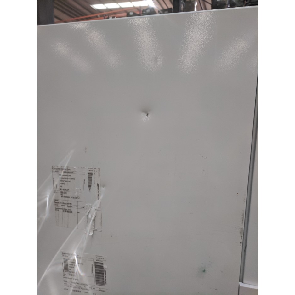

    Tony, I’ve found a possible replacement unit that is ‘graded’ with one year warranty because there are dents, one of which has punctured the insulation to the fridge. Would that be a reason not to buy it functionally (I don’t mind about cosmetic)?
    #466133
    heron
    #466134
    Tony R
    The hole looks like it is a place that will not be near any refrigerant pipework, so should not be an issue.
