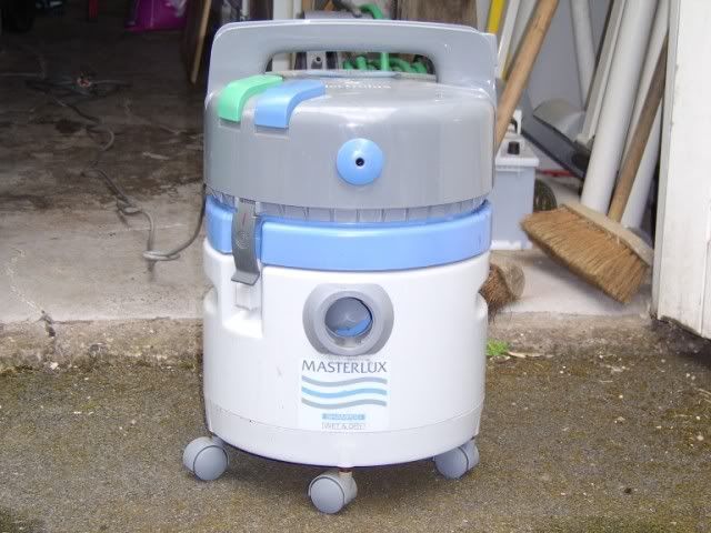

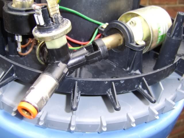

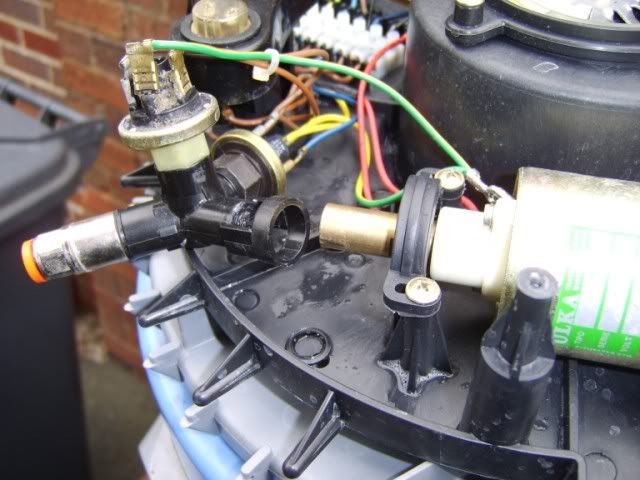

    Hi everyone.Ive recently been given a masterlux 3in1 cleaner thats badly leaking.Whats happened is the plastic tube that connects the pump motor to the Y valve has snapped,I think its been hit hard at some point to have broken it.Is it possible to repair or replace this item as I dont really want to buy a new cleaner just for the sake of a broken piece of plastic.Sorry for no model number as I cant find one but hopefully the pictures will make up for it.

    Cleaner.
    The part that has broken off.
    Just another pic.

    Ive now had a go at repairing it and it does seem to be holding together.I have drilled an 8mm hole in the plastic Y piece and done the same on the brass tubing through the plastic that was stuck in there. and glued a piece of 8mm plastic tubing inside and braced it all together,hopefully it is going to do the trick.
