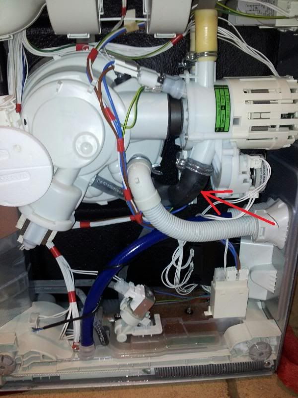

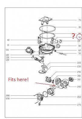

Thanks Don, yes not too clear from the diagram…here’s a pic :-
I think it’s this one??? :-
Unusual one this one, looks like a chemical has affected it at some point as it’s exuding a sticky clear brown liquid and has gone very soft in the area where it’s developed a pinhole.
Incidentally, i’ve seen this on other machines before and never got to the bottom of which chemical has done it…of course the owners never put anything in they shouldn’t 😆
