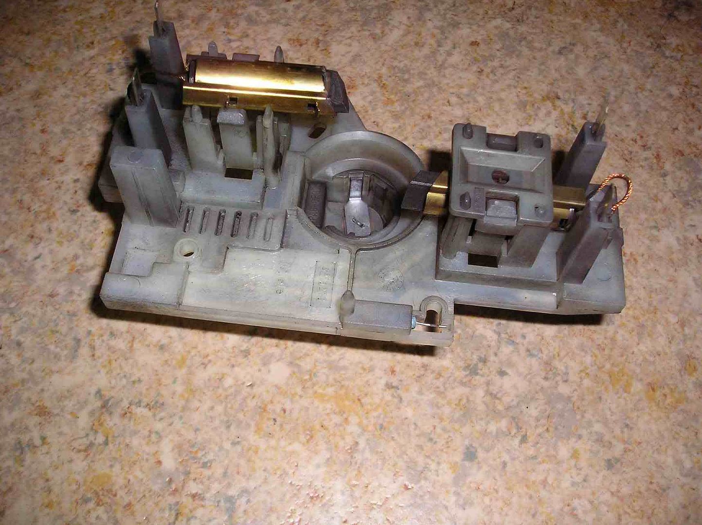

    I can’t see how you could fit the belt from the front. The wire from the carbon seems to be welded to the holder part way down its length then extends to clip into a socket in the brush ring. Do I need to cut the old wire off and solder the new one in?

    order and fit the whole cartridge, comes complete just as in the photo. Those electrue carbons are naff believe me.

    You should be able to fit belt from top, just locate it onto motor shaft first & then t one side of pulley, sometimes i’ve used a cable-tye to secure it, then slowly rotate drum & it should go on to drum pulley ok. by the way tou didn’t need to take off motor or belt to change brushes, whole job is done from frot of machine, remove front cover & front of motor comes off be careful when putting back on, make sure locating pins go in ok & push brush all the way in to armature from both sides with a little screwdriver, best of luck with it.

    The ones I ordered are supposed to be genuine Miele (MLE1689370)
    That’s why I thought it odd that they don’t just clip in or whatever. Thats interesting, splitting the motor with it still in place, never thought of that.
