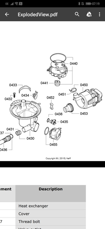

    Part 455 in this diagram?
    https://i.postimg.cc/sfPJ9Htg/Screenshot-20190726-071927-com-google-android-apps-docs.jpg
    When I first cleaned the impeller, there was what appears to be a broken/decayed rubber seal in the bottom – do you think that’s relevant? I can attach a pic if helpful.
    #462580
    electrofix
    unlikely if a seal had come off it would leak. there is no seal around the impellor
    #462581
    Donny Grumbler
    electrofix wrote:unlikely if a seal had come off it would leak. there is no seal around the impellor
    OK.
    Can I confirm that you’re suggesting part 455?
    Cheers again.
    #462582
    electrofix
    yes
    https://shop.ukwhitegoods.co.uk/drain-pumps-1750/pmp1041-compatible-dishwasher-drain-pump
    but I cannot promise a cure as it could also be a faulty control board
