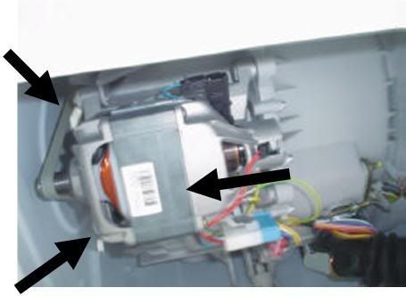

    Installed my first ISE5 v2 yesterday.
    Having sold it blind I was overall very pleased with the machine. Nice and quiet, easy controls and display lights bright enough.
    Was wondering has any one tried removing the motor on the new 5 or new 2 yet???
    Must be a pig to do???
    I’m sure if any other manufacturer had no access panels at the back we’d be cursing them. Or is it just me again???

    #250589
    Re: New ISE 5 questions.
    2 Motor Out
    Like that (belt off first).

    #250591
    All you do is lean it to the side, rather than back – plenty of room. Think plastic tank Bosch.

    I think the problem that you like the rest of us are having is that there is very little room for geting a 40 Torx bit into the end of the two motor fixing bolts nearest the back of the machine, as there is very little room to play with.
    Perhaps this might help as it’s the shortest reach torx 40 bit and ratchet I could find :-
