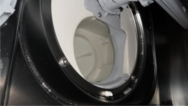

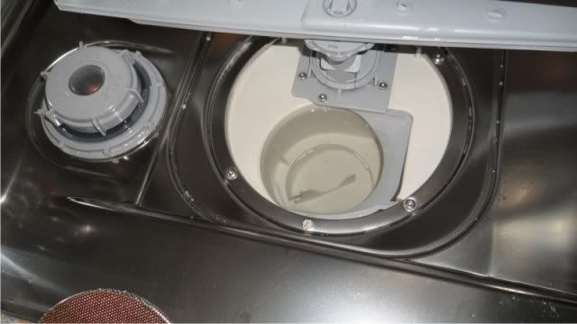

    Thanks for the reply, Steven. Since my last post I tried to fit the older, secondhand module and it threw up an 11 flash fault code. I suspect this is just because it was the wrong module.
    I have noticed this heater pressure switch as a potential problem. However, I can’t find it! My machine doesn’t seem to have the black grid! I have attached a couple of pictures of the sump area to illustrate. The heater does work on the test cycle though….
    I would love for there to be some solution like this as I reckon the module could still be OK. If you guys can tell me where to find the pressure switch on this model I’d be delighted to clean it!!! It may be that this Prima is a bit different from other models. Its a Prima LPR600/1. Model No: 8545 600 15880. There are no references to this model on the Whirlpool website.

    Re: Prima LPR600 puzzling problem.
    Done a bit of checking on this – you’ve got an oddity here. The level switch is (obviously) not fitted to your appliance, which would suggest that water level control is purely a function of the flow meter.
    However….. Looking at the parts listing for that 12nc code shows that the level switch is listed, under “Kit”. I can only assume that the kit is the sump moulding, level switch, pcb and wiring as some sort of conversion. As usual with Whirlpool, there is no Tech note or guidance to be found.
