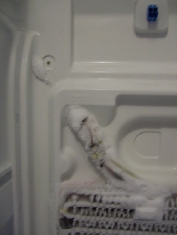

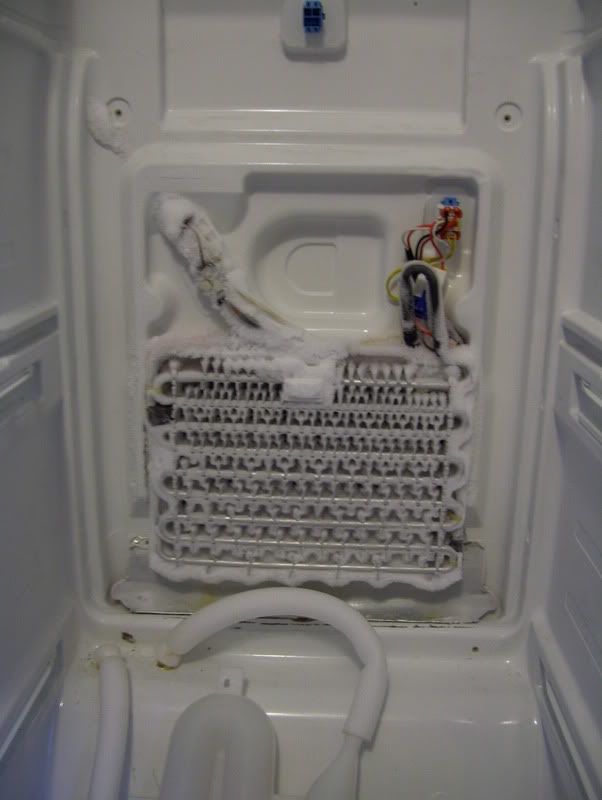

    right then, i defrosted the fridge on sunday, and all was fine again. i knew it would freeze the water tank again, but i wasnt sure how long it would last. however, this morning, friday, i found it had frozen again. on removing the cover, the coil was covered in ice to such a degree that there would have been little chance of air being able to pass over it when the fan was running. it was almost completely solid, especially the pipework to the top l/h side which was completely encased in ice, as the pics show.
    though the icing was worse than it actually looks on the pics,
    there was very little ice on the outside of the evaporator cover just a light icing over about 3 or 4 square inches near the middle. and the fan was running ok.
    any ideas? would be appreciated im wondering how the cover would affect this, as even with a new cover it is still going to ice up the coil.

    Re: samsung water dispenser – doesnt!!!!
    The defrost heater has failed,available from myself r60oahotmail.com
    You may also need to replace te evaperar cover
