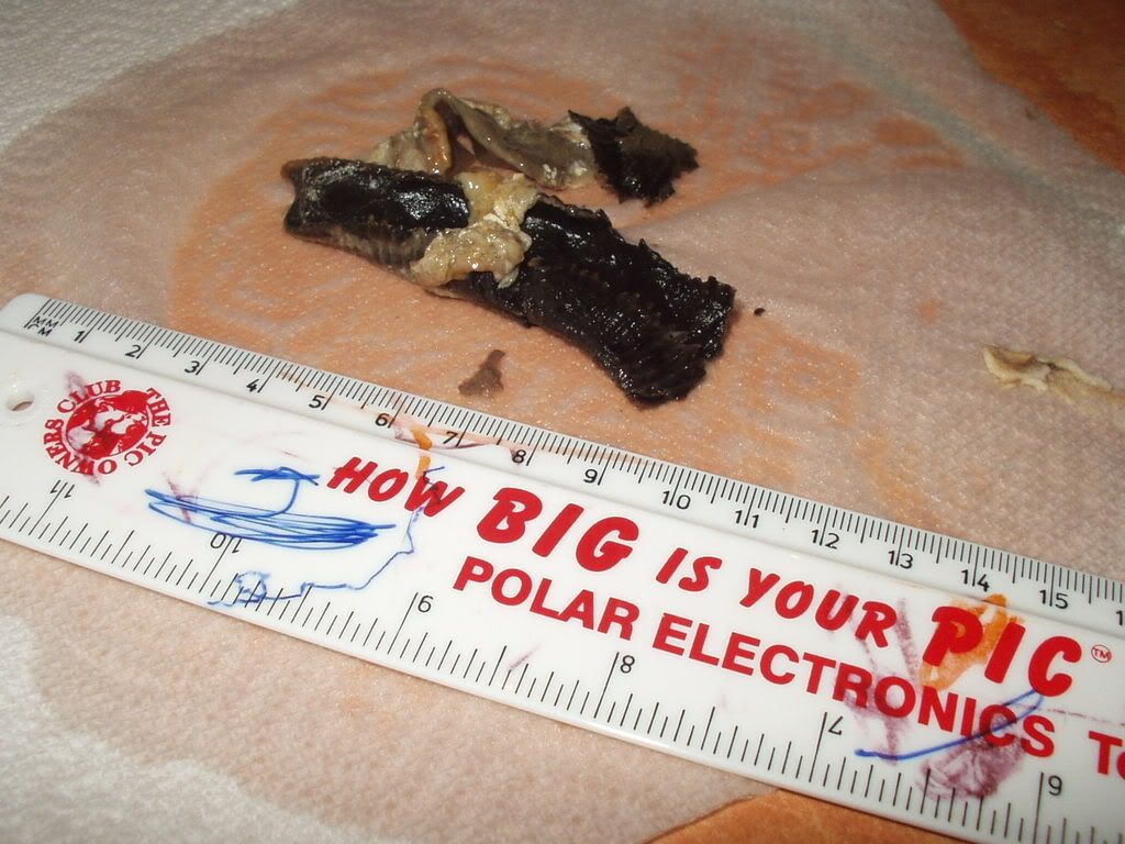

    I removed a large lump of something from the pipe, 415, and it seems Ok now after 1 wash cycle. I will post back again in a few weeks to let you know if it stays OK. I have some photos taken during the fun (!) and a further question relating to one of them, but haven’t worked out how to attach photo’s yet.
    Thanks again for the top notch advice.

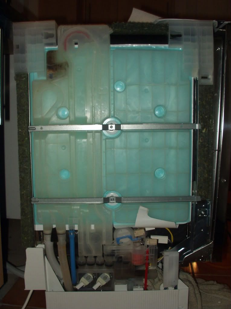

    At last. apologies for the size.
    The pic with the ruler is what came out of the pipe.
    The view of the side of the dishwasher shows a “dirt collection” on the top left hand corner.
    Does this need to be cleaned or even the heat exchanger replaced?
    Any hints on how to prevent this from happening again. We have changed to the Fairy brand of soap and now use a cleaner once a month.

    Hi there – I have exactly the same problem! I have taken the side off and can see as in the photo – the only problem is, which is pipe hise 415??!

    That hose runs around the front left hand side of the machine. In the picture it looks as though it has been removed, it should be in the area of that rather grubby towel.
    Thanks.
    Fred
    One or two people have had some success with a product called Grot Buster from Domestos, apparently if the fill matrix is removed and Grot Buster poured in and allowed to work its magic for 15 or 20 minutes it will often shift that gunge in the top corner. The whole of the area around the pressure chamber, the thing with the red & blue plastic bits in it needs stripping down and cleaning or replacing as well.
    The best way to prevent this happening again is to rinse all dishes properly before you load them into the machine. Remember, it is a dishwasher, it is not a waste disposal unit. 😉
