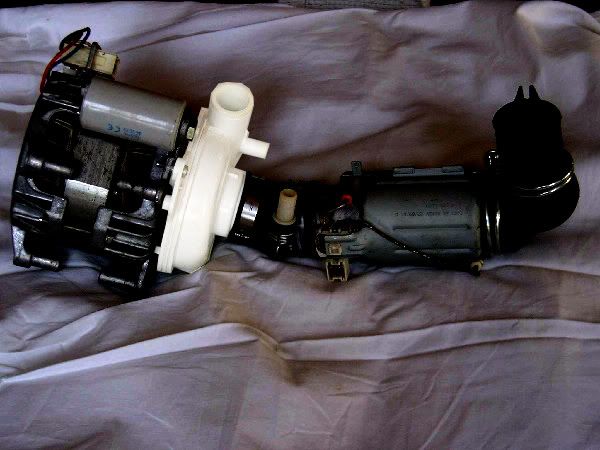

After taking it off and stripping down I found that the threaded connection between motor and impeller had snapped, and this was also where the water had been leaking from (the bearing in the motor is shreiking like a banshee, but I’ve got a spare). I’m pretty sure I just need the white plastic impeller assembly. I’ve used a photo from another thread and highlighted the bit I need:
Is there anything else I should be aware of?
