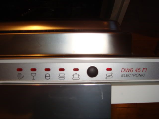

another update:
finally got code:
LED4&LED5 to flash
(the x2 left of the black button)control pcb fascia looks exactly liek this
November 6, 2009 at 7:12 am #302643Jonah
ParticipantRe: teka (again) ADW6 59 FI VR02
Looks like its made by SMEG very similar

November 6, 2009 at 9:08 am #302645gandh1
have a zanussi one kicking about from same era, will it work
ps i stole the pic from another post 😳

November 8, 2009 at 5:26 pm #302647eastlmark
ModeratorRe: teka (again) ADW6 59 FI VR02
The thread is a little confusing as you have posted a pic of a smeg made one but then suggest it uses an electrolux “pulse” type circ pump. Which is it?
If it is a Smeg one and you have tested everything you can then it may be a very slight earth leak on the circ pump, try disconnecting the pump and see if that releases the pcb buttons.November 9, 2009 at 12:37 am #302648gandh1
definitely a smeg its exact same control panel as in the pic, i just didnt see much point in taking a picture, when there was one already on the forum.
