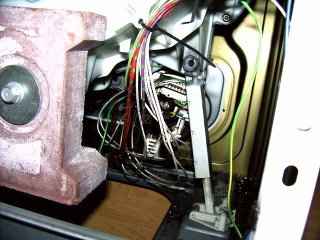

    Re: wma 46 not draining
    Here’s one from this afternoon – tub half changed by Hotpoint three months ago.
    Motor lead chaffed through, fortunately board survived. All the slack was pullled back through and the tyraps actually tightened, as well as securing under the tub by motor – you can see the unused loop.
