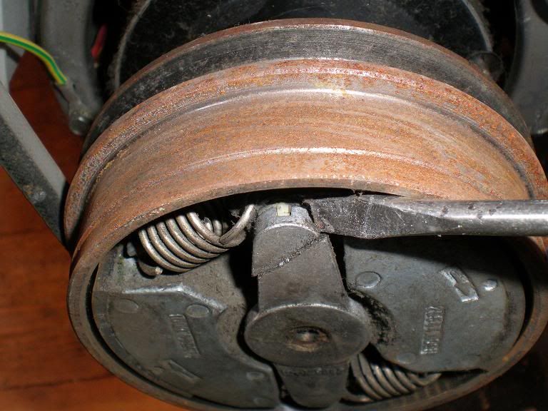

With the Z9191t am i right to presume that it is the inner part of the clutch that is broken ?
If you just need the clutch shoe assembly as it fits onto the splined shaft there is always hope that someone has had one lying in the dust for 20 years, wouldnt be as bad to post as a motor or clutch – so i will have a look on Tuesday.
Cannot promise as there will be alot of dust on it by now !May 1, 2010 at 9:54 pm #319210hotpointtom
ParticipantRe: Zanussi clutch pulley
CJ wrote:With the Z9191t am i right to presume that it is the inner part of the clutch that is broken ?
Cannot promise as there will be alot of dust on it by now !Thanks CJ, much appreciated. The image below shows where it is broken.
[/img]May 12, 2010 at 10:01 pm #319211hotpointtom
Does anyone know how I can remove the bit that’s broken? I can see a circlip behind but it’s very difficult to get to, is that holding the pulley on or the bit I want to remove? I tried pulling the inner bit off the ‘splined’ shaft but it doesn’t want to budge.
Thanks for any help.
