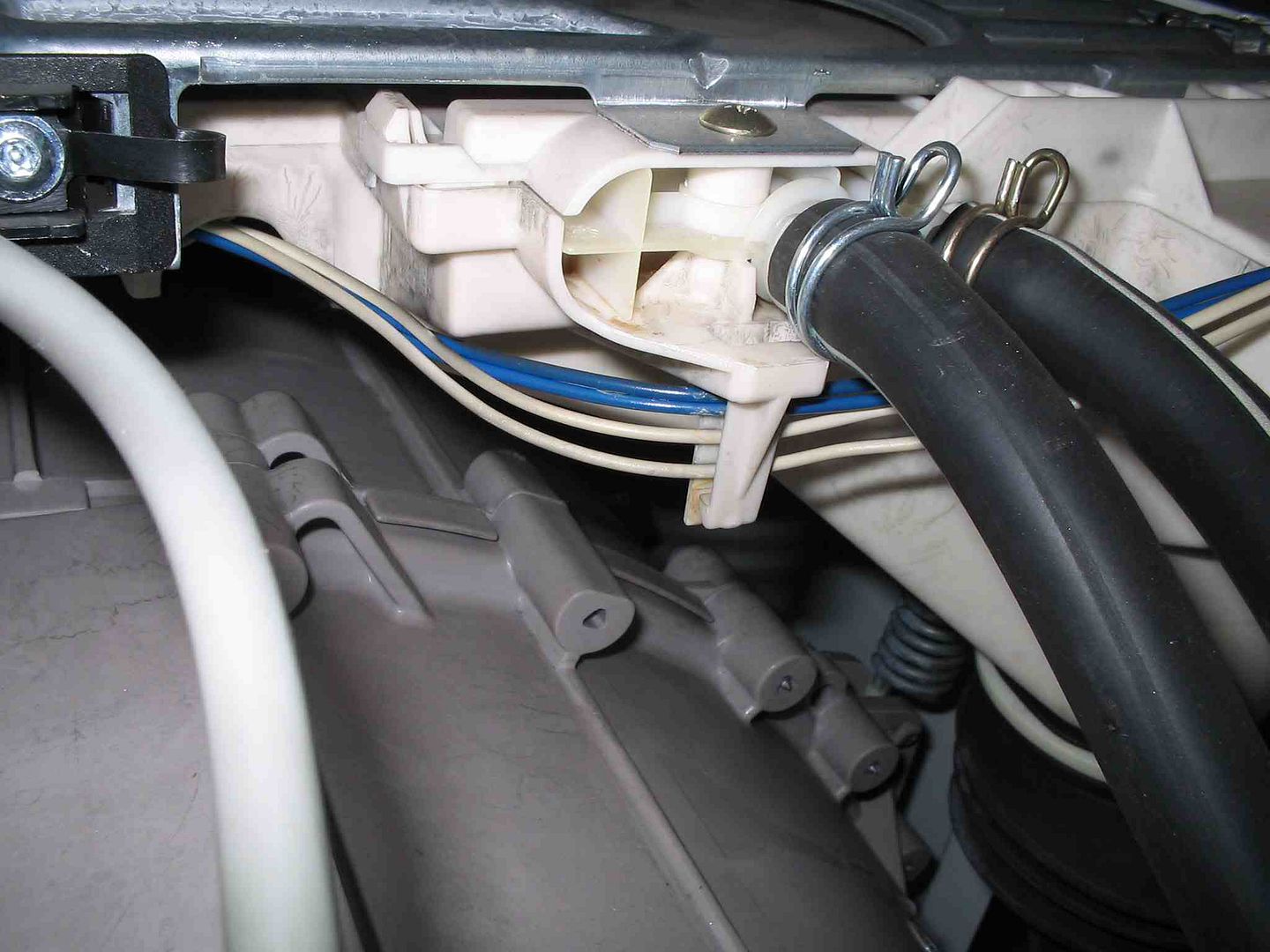

    I have now lent the customer another machine and brought hers to the workshop. I have at least found the leak. It only leaks during the fabric conditioner rinse and the water comes from round the small moulding in the soap drawer housing to which the inlet hoses are attached:
    Could I seal this to the main mouldings using silicone or could this cause an airlock? On earlier Zanussis the ventilation for the soap drawer is clearly visible but I can’t tell with this one. Water did not drip onto the motor during the test wash but I suppose it might do sometimes, causing the programme to reset.
    Phil
    PS sorry about the huge photo but I don’t know how to shrink them. :con:

    The leak turned out to be from the soap drawer housing as I explained. The machine is back with the customer and I’ve not heard anything so hopefully sealing the leak did the trick. 🙄
