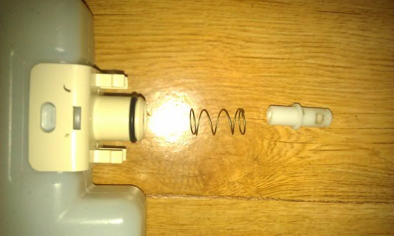

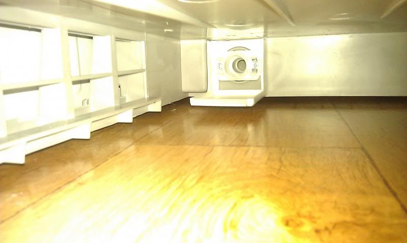

    I’ve attached photos of the tank assembly. Does that look right?
    There appears to be nothing that prevents the spring coming out every time you empty the tank?
    Also, it beats me how it knows the tank is full?

    The valve has sprung apart as the small “o” seal has worn off the back of it causing the rest of it to spring out when you last removed the tank.

    captaincaveman1 wrote:The valve has sprung apart as the small “o” seal has worn off the back of it causing the rest of it to spring out when you last removed the tank.
    Thanks for that!
    That makes sense as I couldn’t see how it would work with the parts that are there.
    I had a look in the store on this site but couldn’t see anything that looked the right part.
    I’ve found that you can buy the valve but that only comprises the piece on the right of the picture above, and the spring can be bought separately too.
    Can you advise what it is I need to buy to fix it?

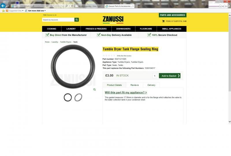

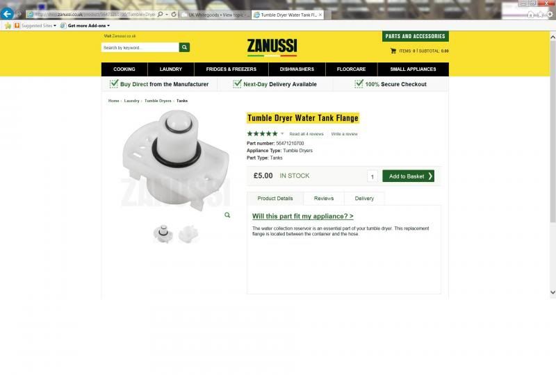

    Would it be this?
    or this
    #407116
    captaincaveman1
    Re: Zanussi ZDC 47200W water tank problem
    Yes the top picture is the complete assembly
    #407117
