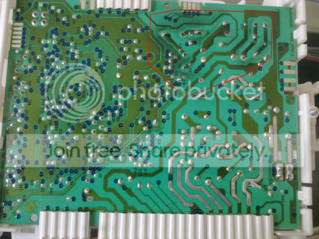

    hey fellers , this is the second one o these ive been to in afew weeks same prob , E 35 on display after diagnostic , checked inlet solenoids , wiring harnesses , pressure switches , power constantly going to big pressostat i had a look at the board and this is awhat i see ,,,,, if i replace the board do i need to replace the big switch also? ❓

    made a hames of the pic , it shows burning on the board at the top centre of pic

    Is that burning or carbon dust? sorry but my eye sights gettin worse !

    Looks like carbon dust on the PCB and it looks like there’s dry joints top left corner. These machines do have problems with the heaters having a low insulation and sometimes residual current leakage from the heater under load that’s not always detectable with your meter that can cause the fault you have.

    i dont have a megger , the board was blown clean , there was a lot of dust on it , blackened the plastic housing it is encased in too , this is whats left i didnt rub it though i’m a bit paranoid about static blowing components , i’m gonna buy a megger in the next few weeks realised its just so handy to rule all the stray earths and poor insulators out once and for all in one foul swoop ha
