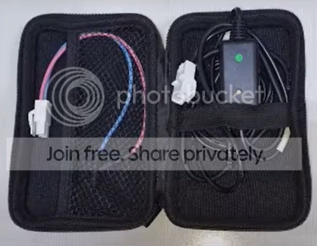

ParticipantUpdate August 2022: – only just found out what it is . Its to be used with a special samsung diagnostic service cable that plugs into a phone:
https://hosting.photobucket.com/images/x361/Andyr_45/hass_cable_clip(2).jpgand the software is called Home Appliance Smart Service app – (only an approved Samsung engineer can order and get login details for it though) It is used to diagnose faults on the washing machine and faulty components.
