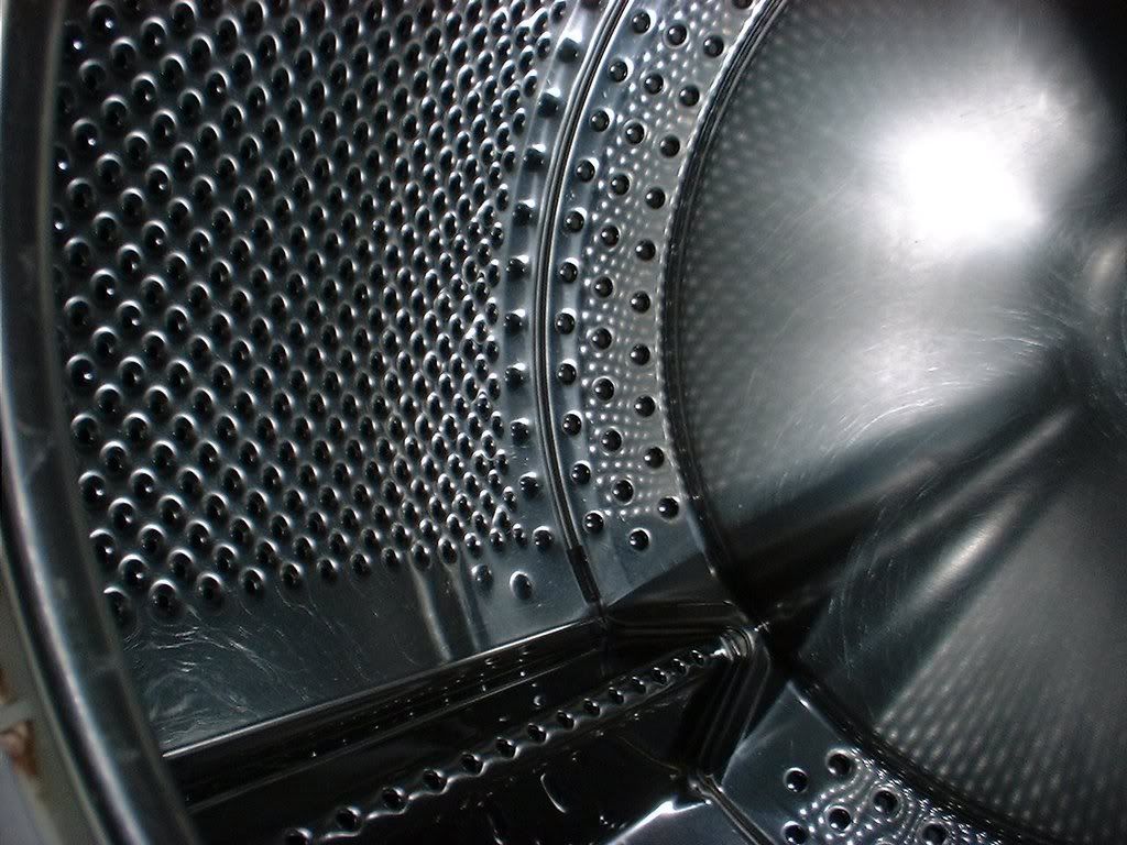

    iadom wrote:To remove the front panel you will need a hacksaw or oxyacetylene torch. 😆 It is a one piece cabinet. The lifters or baffles Martin refers to are the three plastic ribs inside the drum that ‘lift’ the clothes during wash.
    Ah, I think I see the problem. There are no separate, removable, plastic baffles inside the drum. The inner drum is a one piece thing, with the baffles being part of the drum.
    There is a picture taken from the doorway of the washer below.

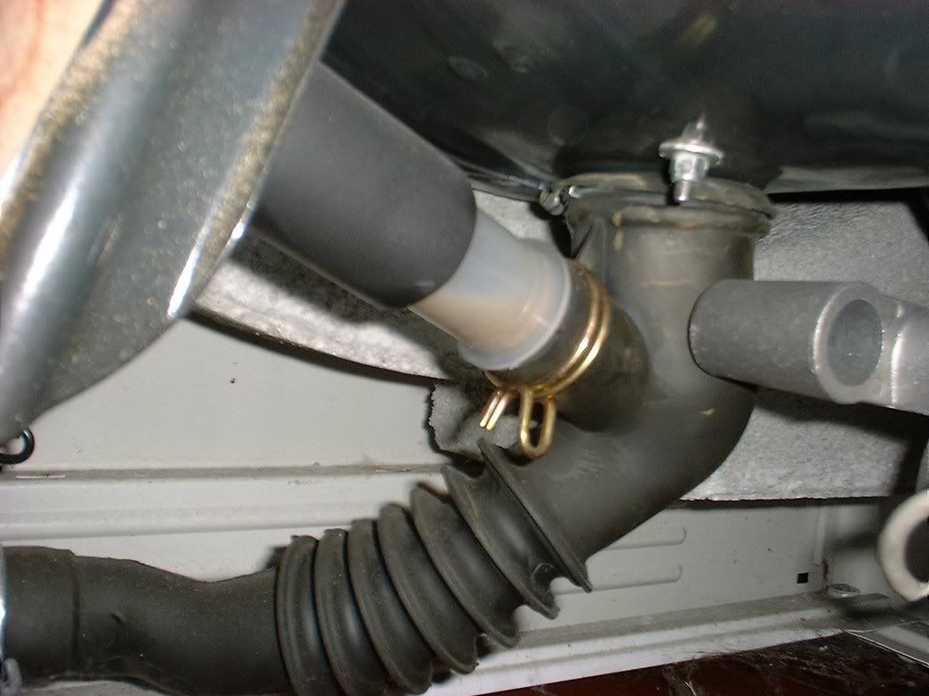

    The hose he refers to is the large black hose from the drain pump. you need to remove it at the outer drum end.
    There is a large black hose from the drain pump to the bottom of the drum. But it’s not just a simple black rubber hose. It is a molded rubber fitting with a complicated looking attachment. I’m starting to think that even if it is just a sock back there, getting it out may be beyond me.
    If I pull the drum towards me (in front of the washing machine), and turn the drum, it doesn’t squeak. I wonder if any missing sock is at the back of the drum wrapped around the spindle at the back of the machine.
    Here’s the drum:
    Here’s the drainage pipe. Looks tricky to remove.
