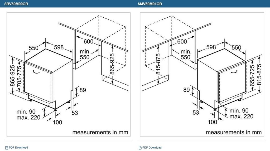

    I am getting a joiner in as all the kitchen fitters I approached were not interested. I need to buy the appliance and then arrange for him to come round. I will be spending around £500 on the machine so don’t want to get it wrong.
    Please don’t take this the wrong way but I can’t help but be a bit concerned that a few post ago you said XXL didn’t exist, and now you are saying the door definitely won’t fit an XXL machine.
    The door is 715mm in height. The diagrams above seem show doors in the range of 705-775 for the XXL and 655-725 for the normal sized machine will fit, unless I am interpreting them wrong.
    Please can you or someone elaborate why my current door won’t fit (or will fit but not line up?) and what the issue will be?

    Just to confirm it won’t fit?
    The doors are around 715mm x 595mm.
    The kickboard top height is around 145mm to 160mm from the floor.
    the overall height to the underside of the worktop is around 872 to 880.
    So what you are saying is the XXL one will fit but the door won’t line up properly with the adjacent units? I’m guessing the door will attach ok from the above diagrams and would have thought it could just be mounted to be level with the others no matter which machine is in place.
    I will be getting the fitter in but want to make sure I don’t order a machine that can’t be fitted easily.

    The only difference I can see is the height.
    Here is a Miele 60cm wide dishwasher that is XXL
    http://www.miele.co.uk/domestic/dishwas … Vi_XXL_K2O
    I should have looked sooner but the site has a bit more info “XXL dishwasher – large capacity dishwasher with a height of 85 cm, giving you even more room in the upper basket for large crockery or long-stemmed wine glasses.”
    I guess that kind of answers my question. I wish the Bosch site had said that. Now I’m just wondering if there are any drawbacks over a normal sized one?
