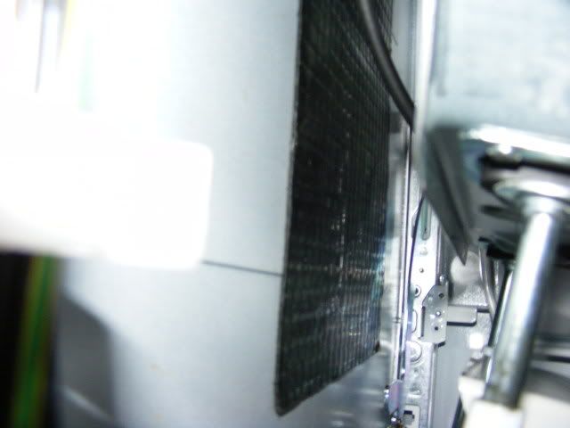

    R/h side panel (from front) was indeed rattling like crazy. I think that it was a resonance issue. The machine is level on a chipboard suspended floor, there is a certain amount of vibration transmitted, but hardly excessive.
    Solution.

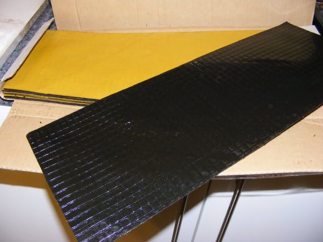

    Self-adhesive bitumen sound deadening pads – 500 x 200mm.
    Fitting one to the r/h panel was effective.
    But, revealed that the l/h panel was doing it to a milder extent, so one went on that side as well.

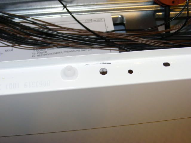

    This picture shows that the lid support bar had been chattering on the top of the r/h side panel and has worn through the paint. Bending the tongues inwards slightly ensured a snug fit on both sides.

    The bitumen pads were bought from an automotive body panel supplier in Leeds; about Β£18 for a packet of 10, so hardly expensive. The rest will disappear into the Wolseley at the weekend.
