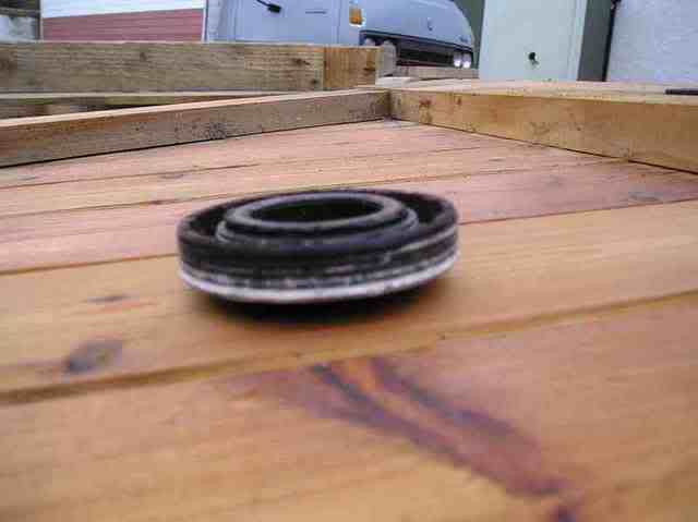

The bearings are 6205 & 6206, this is the seal (sorry it’s out of focus I tried twice but the autofocus must aim at somewhere other than the centre of image):

As I said, the old bearings are 6205 & 6206 with the small seal shown in the photo. My 1004473 bearing kit is 6206 & 6207 with a bigger seal. The customer was not willing to pay extra for a half drum + spider so it was another abortive attempt at earning a crust 🙁
