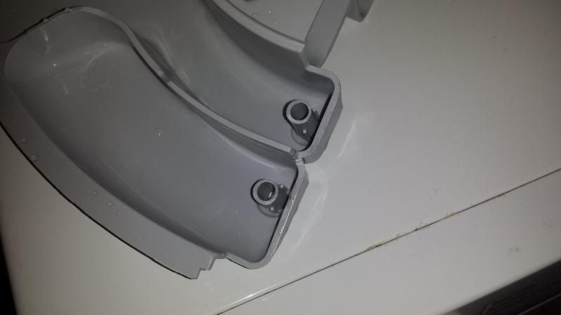

    Been to one recently…this particular one wasn’t leaking but it wasn’t syphoning out so the fabric conditioner compartment and bleach compartment were both left full of water at the end of the cycle so I set about modding the tubes…
    These are the tubes in question :-
    As you can see they certainly sit with their tops above the back edge of the drawer so successful syphoning can only start if the flow of water into the compartments is high enough to raise the water level right over the back of the dispenser. Note also some slight distortion to the compartment although I can’t see this having any bearing on the problem :-

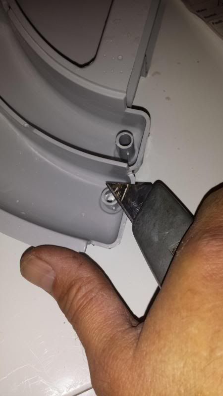

    So….out with the stanley knife and carefully trim down the height of the tubes :-

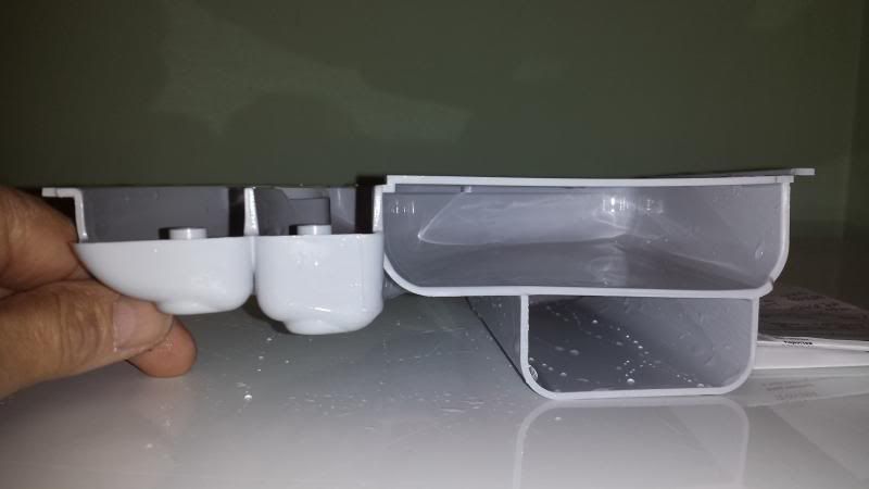

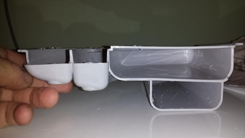

    Both tubes now finish flush with the top of the back of the compartments :-
    Lastly, a quick check under a running tap to check the function and the result…the compartments both drain freely and easily…
    All in all a very easy fix!
